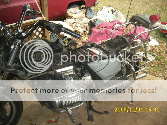

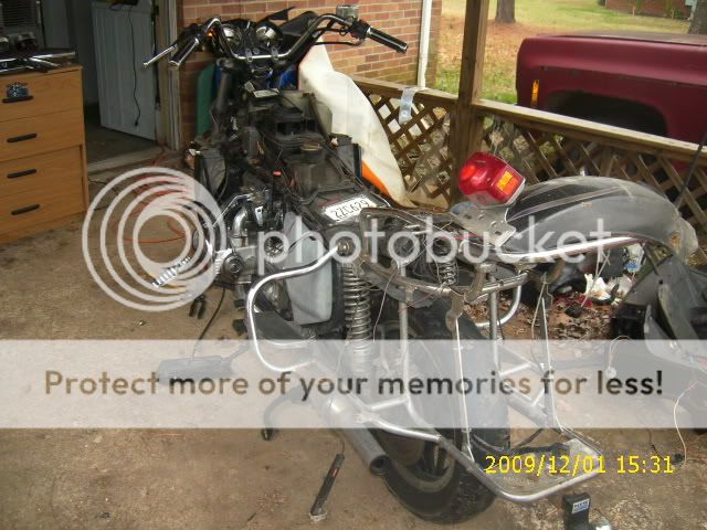

I got a little more done as far as tear down this afternoon. It's just too darn cold to work outside for very long at a time.
Now to get to work on the water pump change and some major clean up.

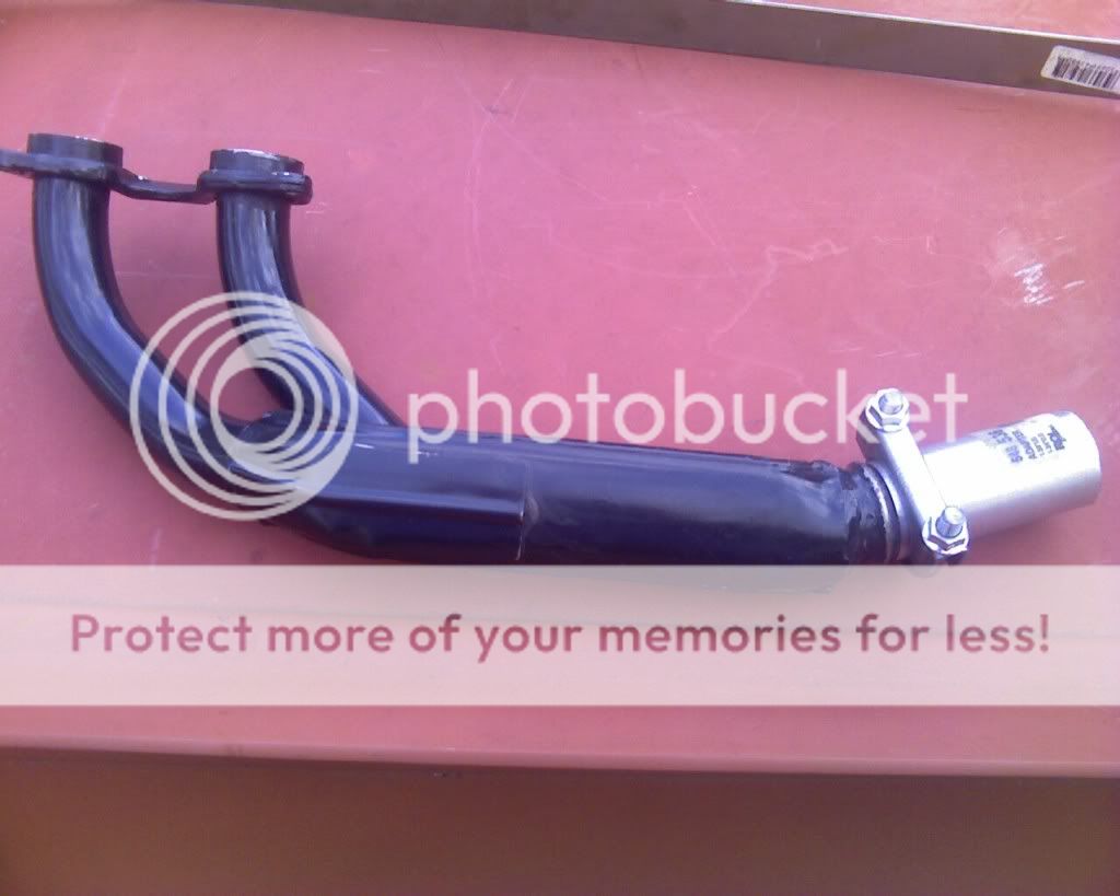

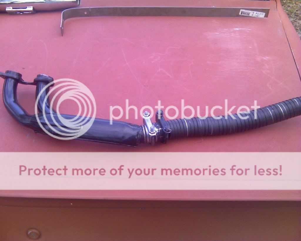

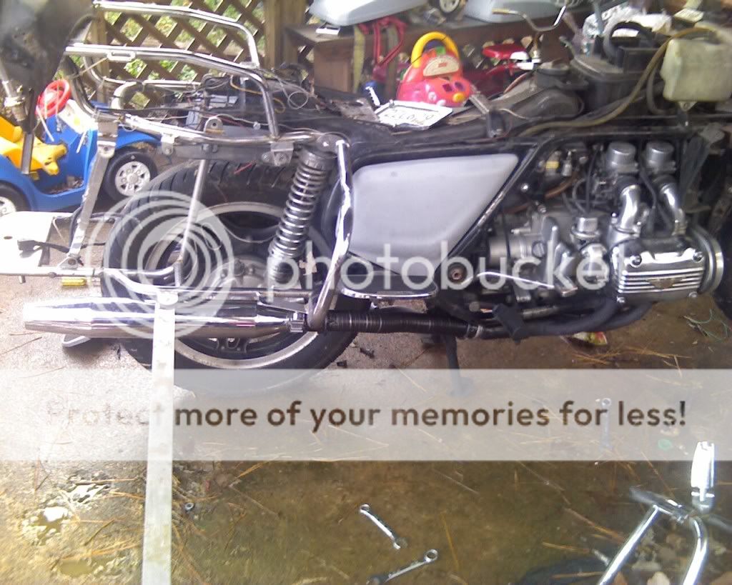

I just added an HD exhaust to the old girl today. Here's the setup I used. A little odd, but it worked out for me.
Parts list:
Headers
Metal for a hanger
Connectors
Crush Gaskets
Flex tube
Clamps
HD mufflers of your choice
I started with a set of headers from a GL1000 that I picked up on the cheap. I painted them with BBQ high temp paint.
From there I put on an 1 5/8" ID connector with a 1 3/4"OD to fit the 1 3/4" ID flex pipe that I bought. This part might need some gentle persuasion to get it to fit just right. Now, for future reference or for someone wanting to do this to their bike, I would recommend getting the 1 5/8" ID flex pipe if you are able to find it as it will cut down on the number of connections you have to make.
From there I used a 1 7/8" ID reducer to mate the 1 3/4" ID mufflers with the 1 3/4" ID flex tube. If you were to use the 1 5/8" ID flex pipe, you could possibly get away with out a connector here depending on how thick the wall of you tubing is.
To hang the muffler, I bought a 1" wide steal bar and made a couple of brackets and bolted them to the saddle bag stay and used the existing mount point on the HD Dyna mufflers to bolt it to.
I still have finish cutting the bar to length for the muffler mounts, but you get the idea behind the whole set up. It is nothing fancy, but I like the way it looks so far. I don't have any of the plastics on the bike right now as I am getting them ready for paint, but I'm sure this mod is going to make a big difference in the end.
I'll try to get a video for a sound demo ASAP.

Crude but effective . BTW those are 1100 headers which is a good thing, the 1100 headers are more stoutly built than the 1000 headers.
- Posts: 763
- Joined: Tue Aug 11, 2009 11:07 pm
- Location: Goodspring, TN
Very interesting. I didn't realize that the 1100's ever had a seperable exhaust. As far as crude, yes, but I plan on taking her to an exhaust shop to have the mid pipe replaced and welded at some point.
