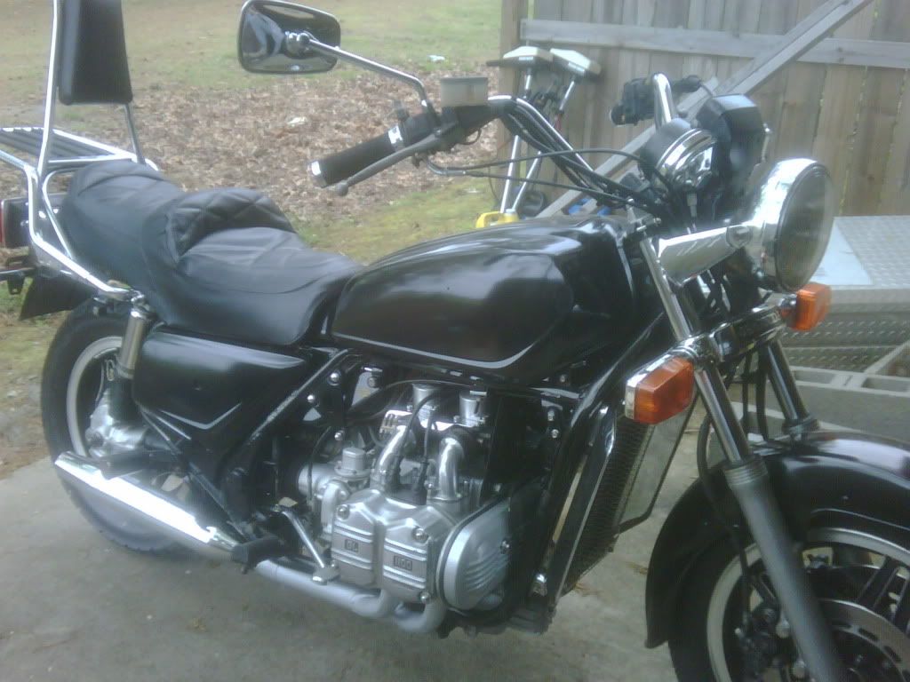

I've spent all winter on this beast.
I'll take the time to describe the past later, this is the big project I finished today.
Started with this collection of parts:
I abandoned the idea of using the 20* fittings and went with 2" to 1-3/4" adapters instead.
I did a lot of grinding and fitting with the angles and could not come up with a way to keep the angles set from mock-up and fitting to the transport to my welder's. I like it straight better.
If you want the down and dirty, I simply ground down the old muffler to manifold welds, leaving the top weld seam as a keyway of sorts. Then, I pounded those 2" adapter onto the manifolds and set the angles with the mufflers slipped on. Carefully slipped them back off and went to get them welded. Worked like butter.

This is how they looked before finish grinding and header paint:

I only had one of the Harley Sportster clamps, so i reused the one from the original crossover joint. Had to grind its ears off to get tight enough. I'll replace it with another HD clamp whenever....
Sounds quite nice.
Still need to fab muffler mount brackets and a center stand bumper (still debating removing that thing).

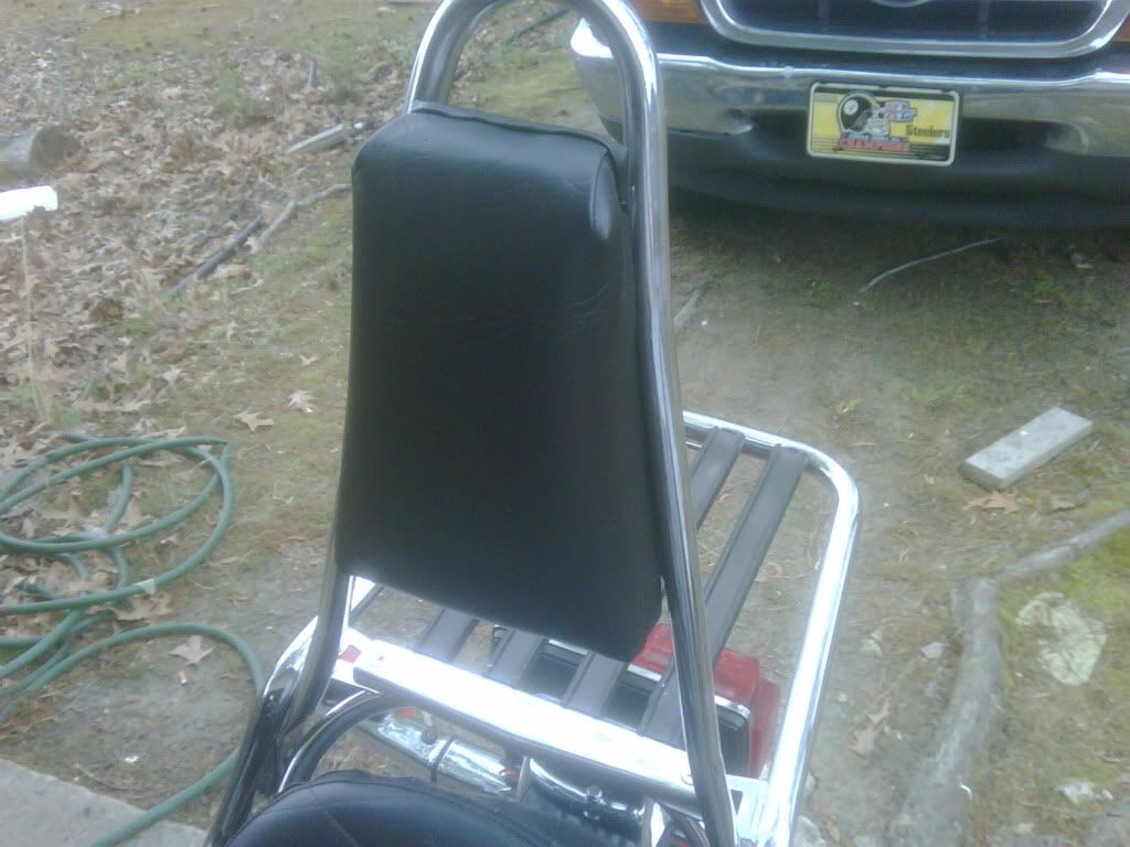

I fashioned a pad for the sissy bar today.
I think the wife will appreciate it.

Here's a side view showing the newly installed seat fabric.
