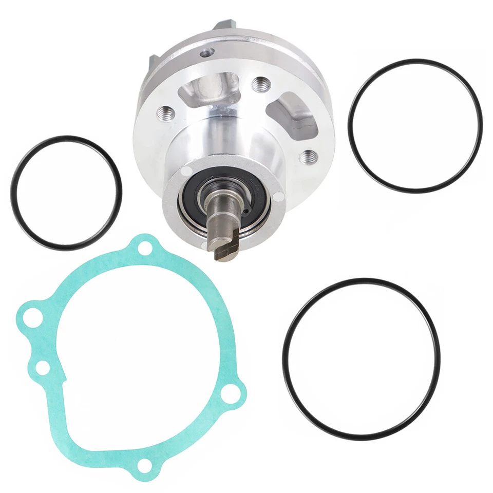

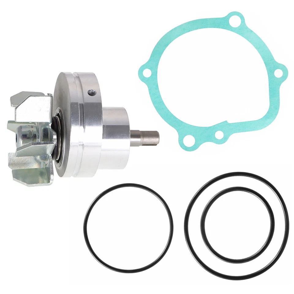

Has anyone tried these Chinese water pumps? Is it interchangeable or will it fit the gl1000?
