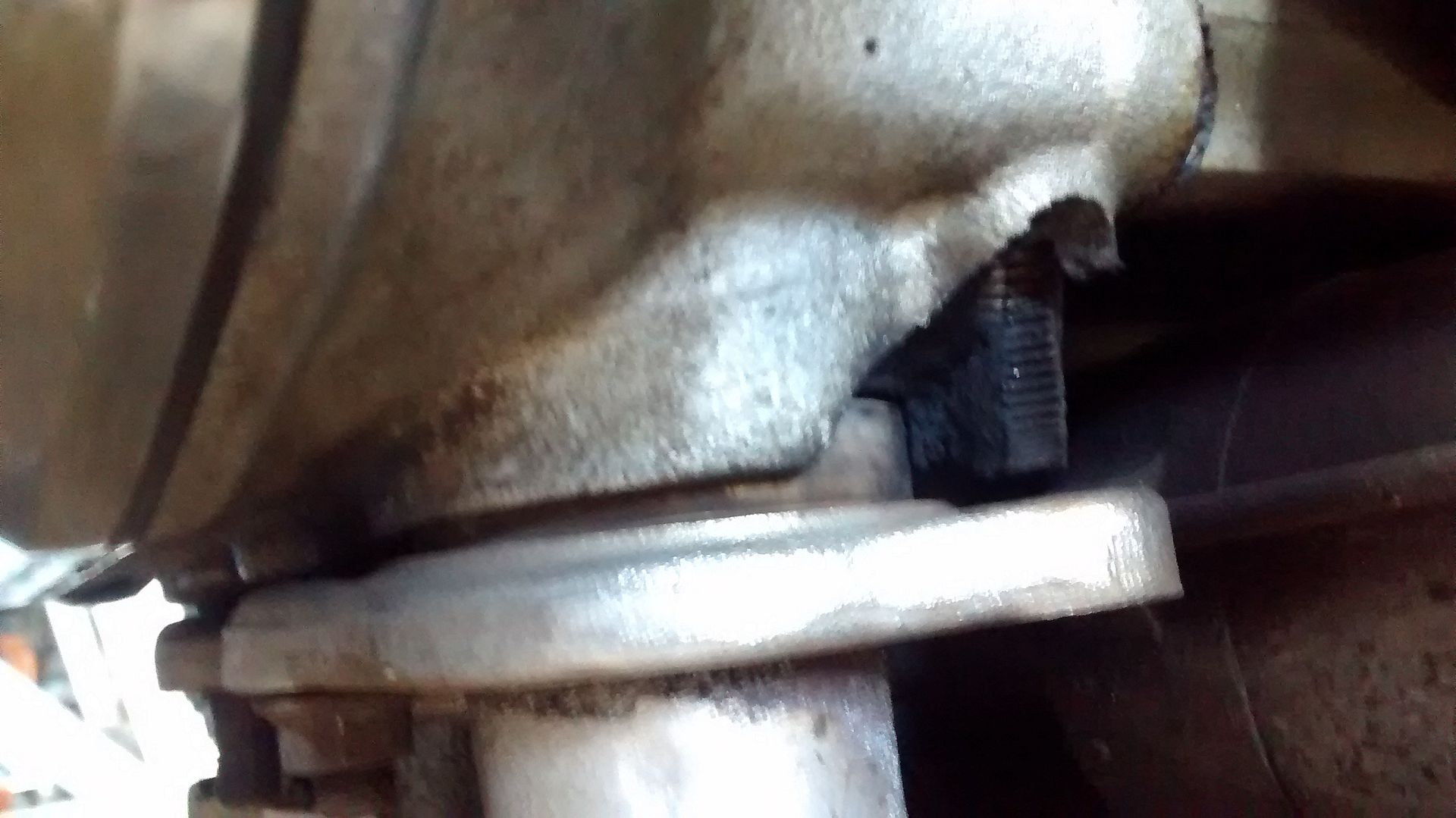

LOL well funny enough I ran it yesterday for a bit and the smoking stopped ??? . Checked the fan by shorting the switch out and it did come on, so happy there. Do have to troublyshoot the RR as its charging at 17.5V and I sure dont want to kill the new AGM battery I use for my CX500C. Going to get a set of exhaust crush gaskets in it so I can quieten down the exhaust and make sure the bottom end sounds ok

Also may have to replace the left side heads due to a missing exhaust bolt section
http://i1237.photobucket.com/albums/ff4 ... ljv4my.jpg
