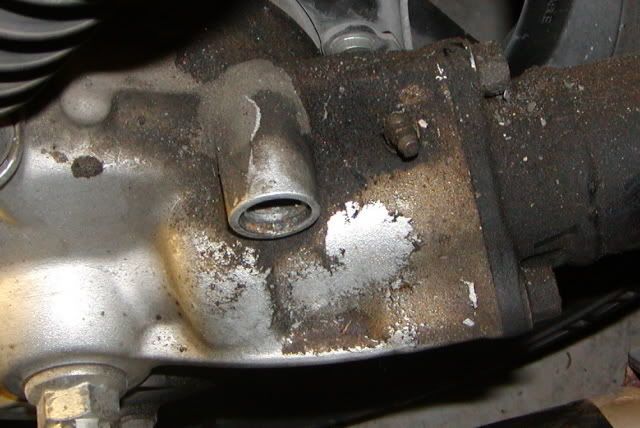

I am very concerned about some of the harsh and dangerous chemicals that I use to clean my 'Wing parts. I've started using a new technique that may work for you:
Here is what my final drive looked like before I started.

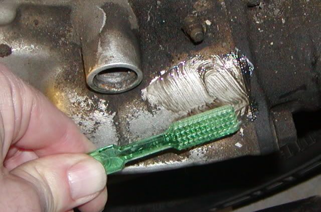

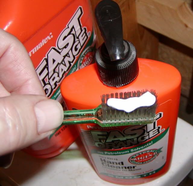

I put some Permatex Smooth (not gritty) FAST ORANGE on my wife's toothbrush.
Brushed the FAST ORANGE onto a section

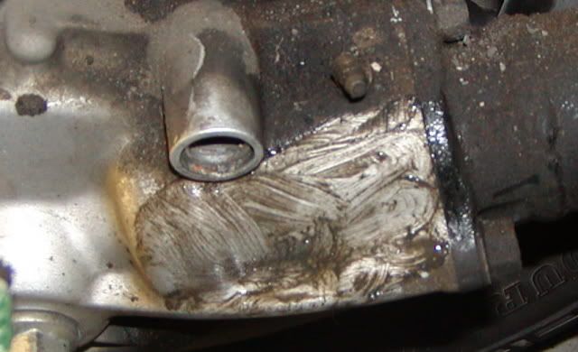

Let it soak a couple of minutes

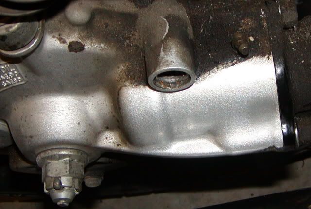

Wiped it off with a rag or paper towel and here's what I got!

rufussrgnt wrote:Here is what my final drive looked like before I started.
Why in the world would your final drive look like THIS??? :-?

I don't know why the final drive looked like that. I just bought it and am now tearing it down. This mess was hidden behind the 'bags. I guess the previous owners philosophy was "out of site out of mind".
