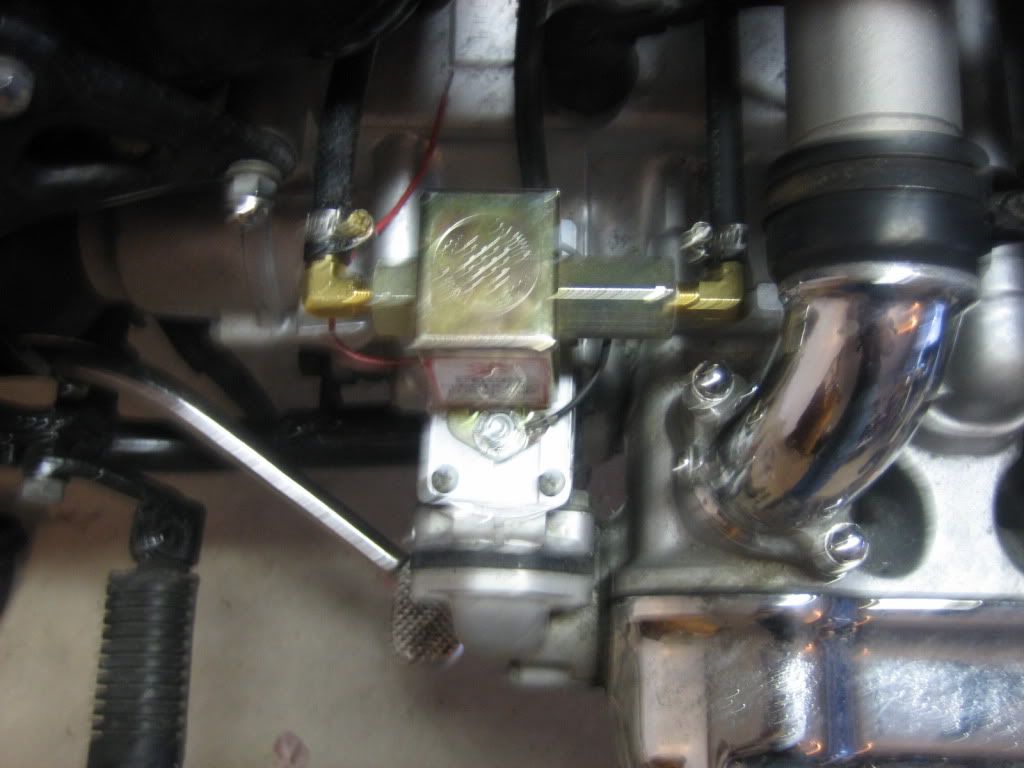

I've got a bunch of those cracked pumps. the only use I've had of one was this. Sorry it's fuzzy, I used one to make a mount for an electric pump.

Is that the pump from Randakk's or did you do that yourself?Cookie wrote:I've got a bunch of those cracked pumps. the only use I've had of one was this. Sorry it's fuzzy, I used one to make a mount for an electric pump.

Re: Gold Member
It's one I picked up from Ebay. They are pretty standard pumps you can get anywhere. If you use one with stock carbs make sure it is a low pressure as stock I think they run 2 lbs.
The joy of Randak's kit is that it is all developed and bolt on. If you do it yourself you have to make a mount and block off the old holes.

Yeah. I was looking at Randakk's kit after my last reply. I did a bit more research and the 3 fixes seem to be,1. to get a new OEM pump. I'm waiting for the final price, but it looks to be close to 100.00. 2. get a GL1100 pump I guess it has a slightly higher volume, but not too much to push the floats off the needle and have better low rpm fuel delivery. And 3rd go the electric route. I read Randakk's description and the price for the standard kit is $150.00 shipped. I would pay about $110.00 to get a standard OEM pump and I do like the idea of the constant (non-pulsing) fuel deliveryof the electric pumps. Some people are saying that it really does help the motor run better at low rpms. What do you think?Cookie wrote:It's one I picked up from Ebay. They are pretty standard pumps you can get anywhere. If you use one with stock carbs make sure it is a low pressure as stock I think they run 2 lbs.

I think the joy of the electric would be to eliminate the several stalls when starting after sitting a while. My bikes always start but they take some ranking to get fuel up there. We have had about 15 days of rain and my yellow bike did the fire, stall thing over and over like always when it sits. That can't be good for the starter.

Well, I was debating about getting another mechanical fuel pump or going with Randakk's electric setup. I like the idea of an electric pump and his is nice, but I think it looks a bit out of place for me. At $150.00 a complete bolt on conversion would be delivered to my door. Not that bad considering what you get. The OEM pump would be a little cheaper, but not that much.
In the end I ordered an OEM pump and insulator gasket today. It will be awhile, so still plenty of time to sort out the remaining issues and have the bike ready for the road by the time decent weather hits.
