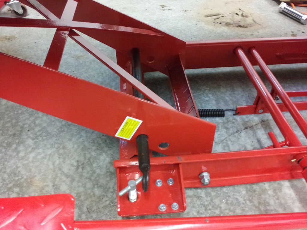

I agree that this is an interesting read. I'm with Joe Drum and MikeO. I don't want that one (even at 10 cents on the dollar Doug).
All the attaboys you're giving to the HF people (well deserved - a lot of places wouldn't have bothered to respond) will go out the window if that bike hits the ground.
Keep your phone in your pocket when working on the bike. Depending on what side it goes over, you may not be able to reach the land line.

would need some serious modification for sure

that's what she saidJBz wrote: That bar looks small for the hole as my eyes see it. jb

Sorry I am late to this thread, but your lift in the original condition is wrong. The flange plate used as the foundation is upside down! There is no structural strength to a flange plate when the flange is at the bottom. The strength to that plate is when the flange is on the top and the bottom is welded to a structural member such as another plate. When used in the configuration like your frame, they needed to use channel that has a flange at the top and bottom.
The repair you did helps, but there is still a significant amount of stress. Currently, as designed, it is no where near a 1000 lb capacity. Your modification with the square tubing helps.

Correct. The earlier model of this lift (#68892 shown below) had flanges at both the top and bottom of the lower rail. On the new model (#69904) they used the one you see on mine (at the beginning of the thread). Even if mine had originally come with the double flange rail, I believe the undersized bar would still have bent.mcgovern61 wrote:Sorry I am late to this thread, but your lift in the original condition is wrong. The flange plate used as the foundation is upside down! There is no structural strength to a flange plate when the flange is at the bottom. The strength to that plate is when the flange is on the top and the bottom is welded to a structural member such as another plate. When used in the configuration like your frame, they needed to use channel that has a flange at the top and bottom.
The repair you did helps, but there is still a significant amount of stress. Currently, as designed, it is no where near a 1000 lb capacity. Your modification with the square tubing helps. (I work with structural steel and design full time.)
I ran my bike up on mine today, jacked it up, then lowered it on the new support bar. The bar and structural mods held well and seem very solid. Next up, installing the new wheel chock and (non) 'Chinesium' tie-down bolts.

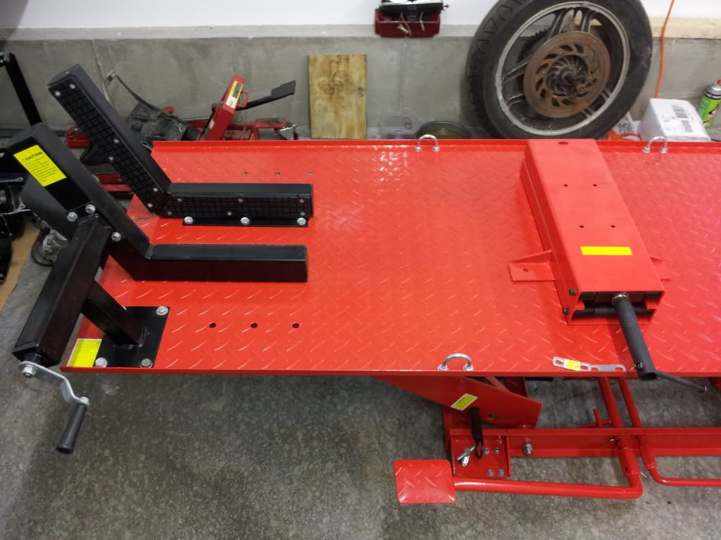

I just read this entire thread and all I can say is WOW. That bar looks like Superman got ahold of it. That's definitely a different HF lift than the one I have and certainly a lot flimsier. Here's mine:
The store manager was on top of his game to give you the discount so that you could pay for the welding. I think HF should do the right thing and offer you something as well. The cost is insignificant in comparison to their daily sales worldwide.
One improvement I made to mine was the investment in a much beefier front wheel vise. I also got a scissor jack for situations when I need to get the front wheel up in the air for removal. I have 3 pairs of U-bolts on the table top for strategic placement of racheting tie-downs as well.
Yes, these aren't anywhere close to the quality of the pro lifts that we've all seen, but for $299 on sale, what can one expect. I don't agree that they're dangerous junk, but judicious planning and use should part of the plan when being put to work. I've used mine quite a bit since I got it a year ago and can't imagine not having it now.
