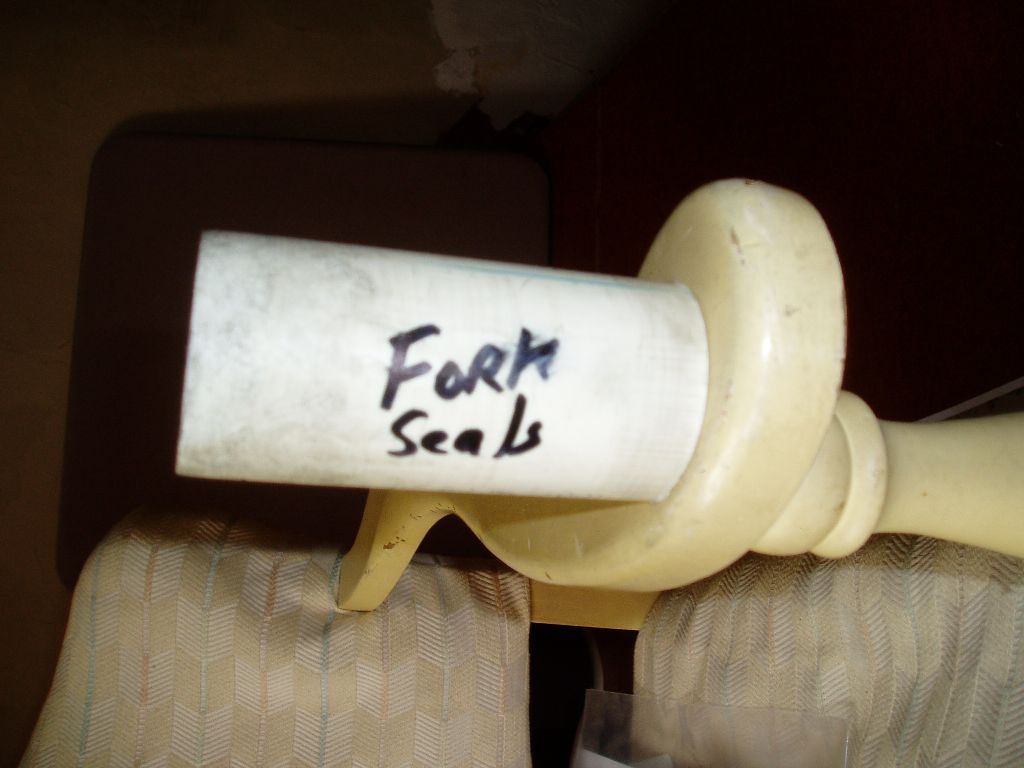

Re: new project: 1975 Gl1000
I always use some PVC pipe shaved down just a bit on the end to tap in seals. Works great. Wood block on top of the pipe and pound away - installed in seconds.

YEP got one hanging on the wall in the shop just for fork seals.

I use a pvc pipe as well. Also the copper exhaust gaskets fit in there.
