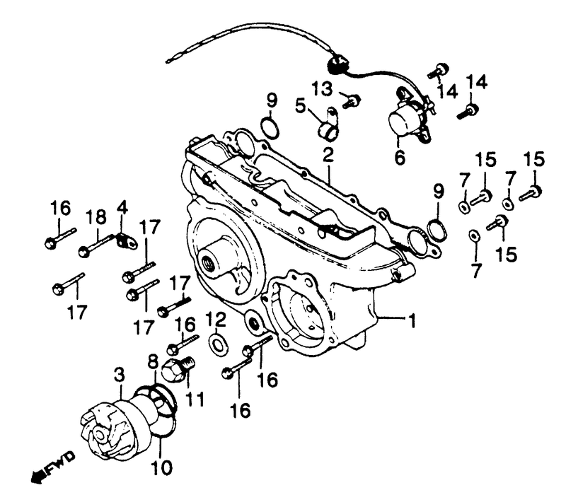

Sorry, you lost me. The neutral switch goes on the side of the engine and only has an o-ring to seal it. And if you have the wrong size the switch won't work right. The transmission cover does have a spot that traps crud but i don't see how it can get into the interior of the engine. Maybe a photo or drawing --or maybe as I often do, you are just grumbling?
- Sidecar Bob
- Posts: 8062
Re: Mr.H's new engine
The 1000 engine has the neutral switch on the side but the 1100 has it inside the transmission cover. Its part #6 in this drawing

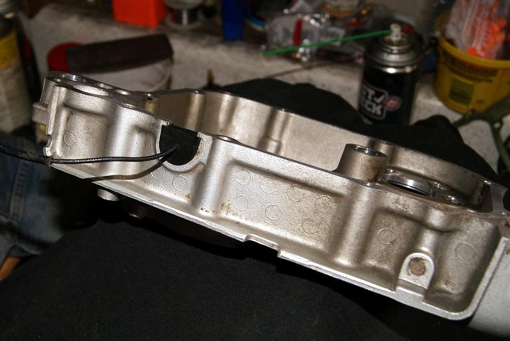

Looking at the cover from above you can see that the rubber no longer fills the notch.

Ok. I am with you now. I guess I never paid any attention to the neutral switch on any of the 1100s I have worked on, including the one I am building at the moment.
Does look like a problem. Maybe some kind of rubber tape?

GL1100 '80 -82(? might have been '81) had the side switch. Later versions have the front one.

This is an '82 so that must have been the year they changed. I am thinking about finding a piece of rubber that will fill the gap plus maybe a mm extra and gluing it to the original.

BTW: I cut a piece of cork gasket material to fill in the gap where the rubber shrunk and glued it in place with some of the Permatex Form-a-Gasket. It is about 1mm thicker than the gap and soft enough that it should squash nicely when I install the cover and seal it up again.
