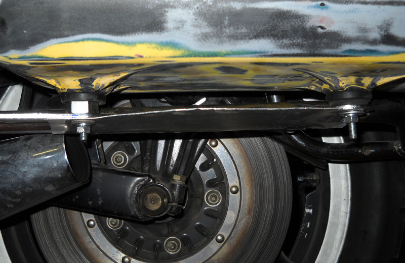

I dug around and found a couple of pieces of 1/16 inch scrap sheet. Decided that the aluminum would be way easier to work with than the galvanized so I went with that. We'll have to see if it holds up and doesn't melt through.
They are held on by the same bolts that secure the bottom of the bags. (That one is just there to hold it for the pic.)
There's plenty of clearance from the shields up to the bags, but the front of the shields are actually laying on top of the mufflers.
