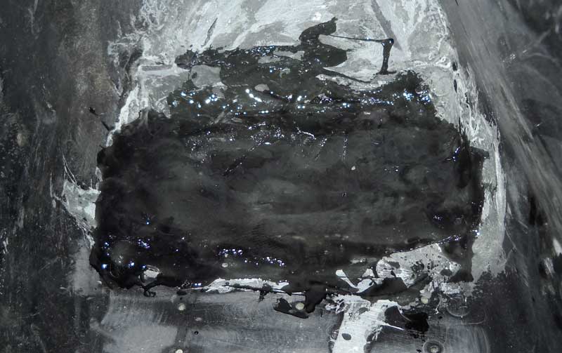

Yep, my wife asked why I spent $20 on it when we have tons of that from NIMBY, the black kitty.
Crashdown said (insisted) that before doing the glazing compound I should sand down the inside and apply a layer of fiberglass cloth and resin. He said that it would keep it from cracking. I'm guessing that's because the kitty hair is kind of soft, it did sand down pretty easy.
So I lied before in that post when I said that I'd never, ever done any body work. About 8 years ago I repaired a crack in the fairing on my FZ1. Bought a fiberglass kit and did a small patch. I still have the kit and opened it up today to find that it was all in good shape.
I sanded the inside of the bag, cut pieces of the cloth to size, mixed up the resin and hardener and did a bang up glassing job on both bags. It's a good thing that this is the inside of the bag.

Not sure the fibreglass was necessary as that Kitty hair has lots of fibre and even if it sands easy it still looks as sound as the base bag and the real limit is the bond between the bag and the patch. Now fibreglass will aid the bond, so if the bond was weak it may not be an issue anymore.
Re: (don't) Flip This Bike! the Resurrection
Roady you are a true glass artist! What do you call your masterpiece?
I think "Glopp" would be a good name for it.
