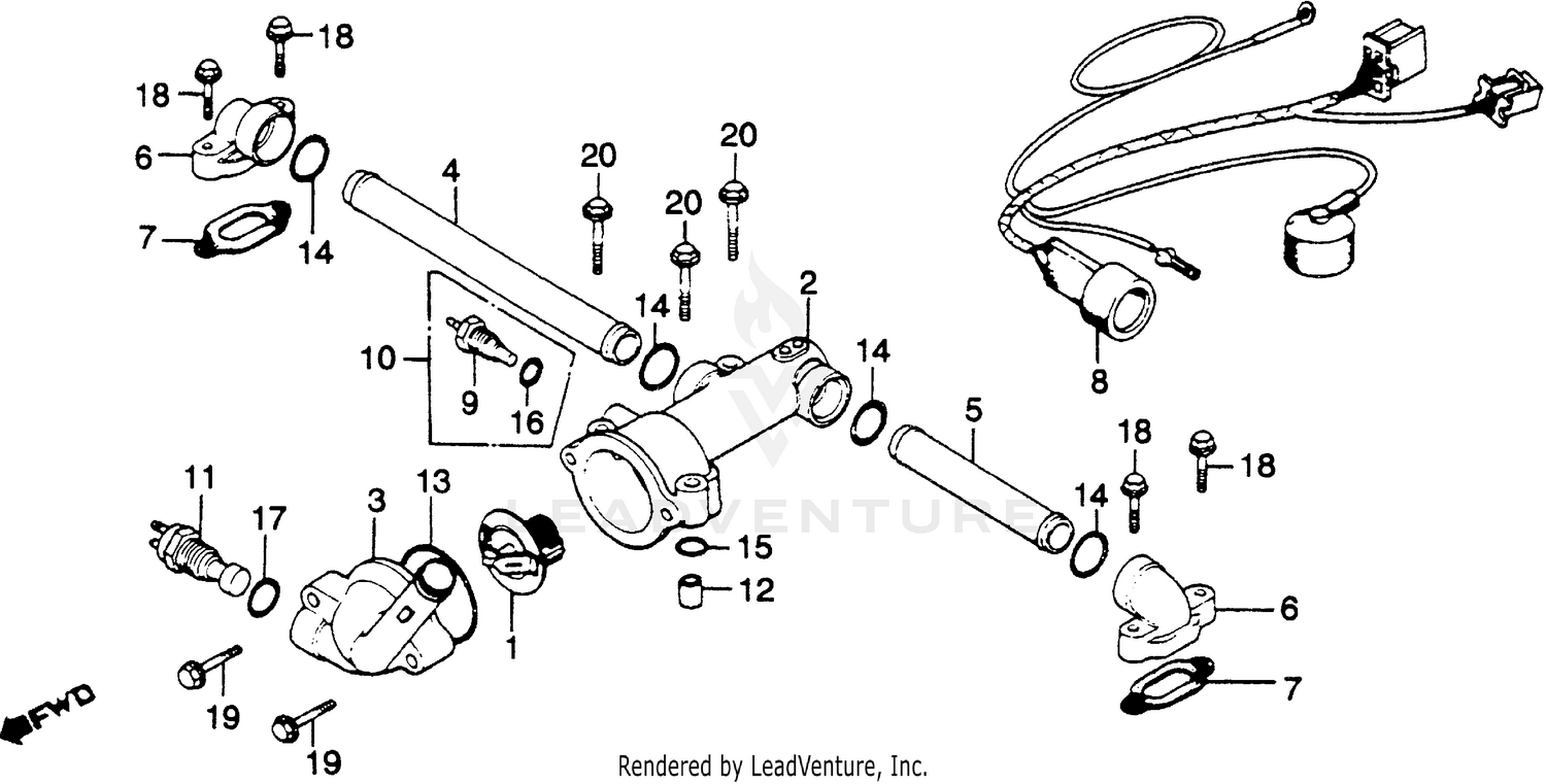

I'm guessing that the leak at the elbow was making its way into the spark plug wells and down the drain holes, which are right between the header pipes...

I'll keep an eye on a water leak around the #2 head. For now, I've moved on to sort out some of the (lack of) brake issues.
All three calipers have really nice paint, actually, so that's sweet. The bleeder valves were so frozen in I feared I'd shear at least one off. The right front 8mm had been rounded off, forcing me to go right to the Vice(grips). PBB, heat, persistence, and, ultimately, taps with the hammer to the ratchet freed things. (Whew!)
Fronts weren't too difficult to get working well enough. I'll do an overhaul this winter. For now, I've flushed them, freed things up, and have good feel at the lever.
Rear is stymied by the master cylinder. I pulled it easily enough on Friday evening, but with all the rust and corrosion things didn't go as hoped. I struggled mightily to free up the circlip.
It took on/off PBB, pliers, and frustration, but it eventually came loose after my Saturday ride with my son. (Fun fact: This was our last ride before he sets off tomorrow morning for a 5-week post-graduation crosscountry trip with his girlfriend - in her Volvo 240 Wagon.)
Then I faced a second big obstacle: the piston just wouldn't come free. I started with compressed air, and the master laughed at my pitiful efforts. After considerable irritation, I opted to get serious and go all hydraulic on its a**. I hooked up a brake line and a lever to the MC outlet. Once things were primed, the piston quickly bowed before the gods of fluid.
I sort of, kind of, knew there's be no reusing the rubber bits and getting this master to prime - and work - but I had it apart and all the pieces were clean. The rubber didn't even look that bad. I put it all together and had what appeared to be a functional rear master. The spring was working to return the lever, so bits were moving just fine. Good omens? I bolted up the master, connected it to the pedal, and added fresh fluid to the reservoir. Then I put a finger on the outlet to start priming the MC. Nada. 50 pumps in and nothing.
I thought maybe I didn't quite get that tiny hole clear, so I pulled it all apart again. I made absolutely certain I had brake cleaner running through and got ye olde wirebrush bristle in and out, confirming things were ok in that department. I decided to bench test before mounting. No workie.
I knew it, really, but was trying to hide from the truth.
Rebuild kit it is.
Bonus: I'll paint the MC while I wait on a delivery. Why not?
Perhaps the next "big" move is tank removal and cleaning.

Put these in your parts order list, too. With these water crossover items in hand, reseal both sides and be done with it.
ref #7 GASKET, WATER JOINT
19429-371-306 quantity 2
ref#14 O-RING (21.9X2.3)
91301-MB6-003 quantity 4
https://cdn.datamanager.arinet.com/imag ... 9aae9c/Max
