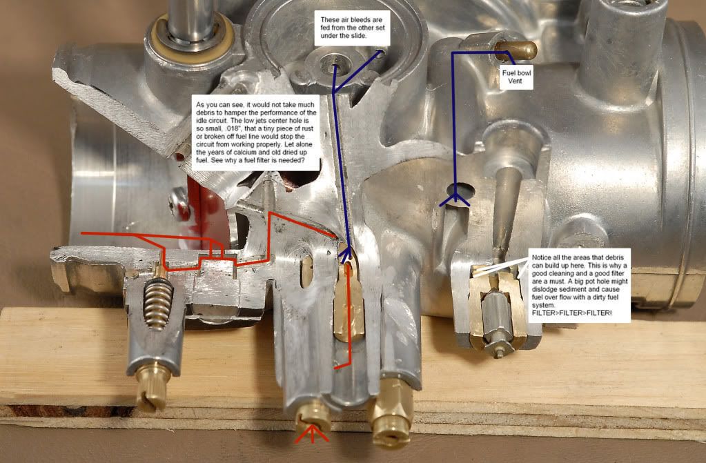

I'm glad the trip over here made it all clearer. Remember though that the carbs benefit from a good cleaning in a sonic cleaner. The debris that builds up on the jets also builds up inside the passages. If they are really dirty it may take a few hours of sonic to do them justice.
This may help you see why the passages are so critical to get cleaned out.

i took the ones off my wifes cx soaked them for 2 days in carb dip and 2 cycles thru my ultrasonic did the regular cleaning
blowing and setup with out removing any of the scary stuff
threw them back on it ran that is all i can say it would not idle or accelerate properly but some progress
i belong to the cx500 forum and had been reading about larrys book so i bought it
read the book
took the carbs off and redid them as per his instructions
put them back on the bike and havent even had to touch the sync on them
adjusted the mixture and idle and it starts and runs perfect my wife loves the thing it never misses a beat
my hats off to Larry on this one he was right about the passages being clogged and them needing to be stripped out
