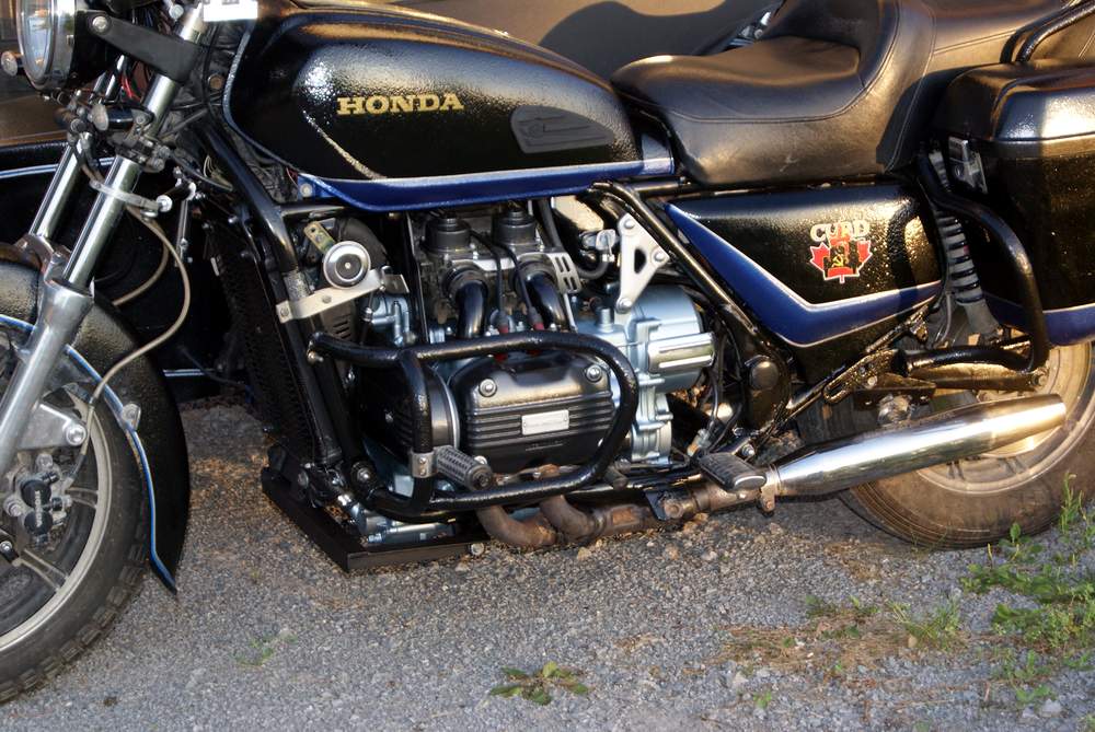

Oh yeah, before I bolted the shelter back on I touched up its paint and added knee pads. These pads look & feel nice and should keep my knees from wearing the paint so much in the future but the peel & stick that came on them was terrible. Not only was there about a cm around the edges without any, what there was wouldn't it stick to the sides of the shelter. and it didn't even stick well to the pads themselves. I replaced it with Macmount tape all the way out to the edges and they seem to be on pretty securely now
