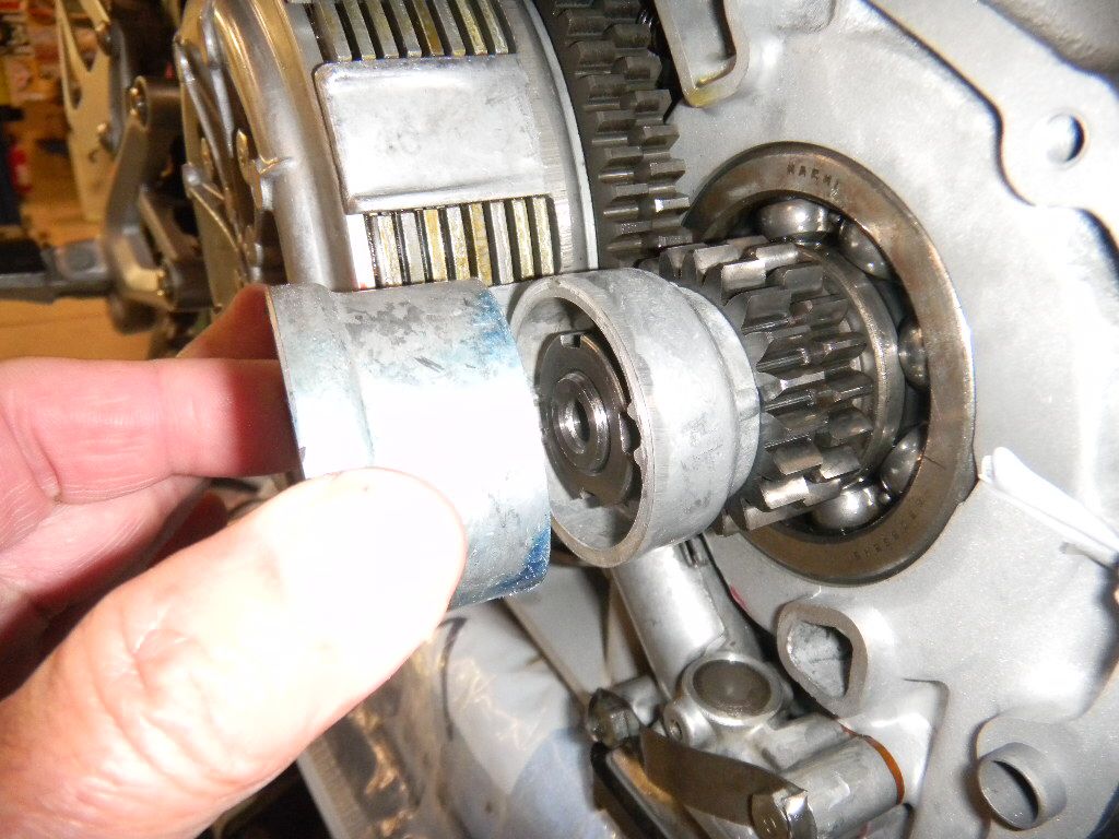

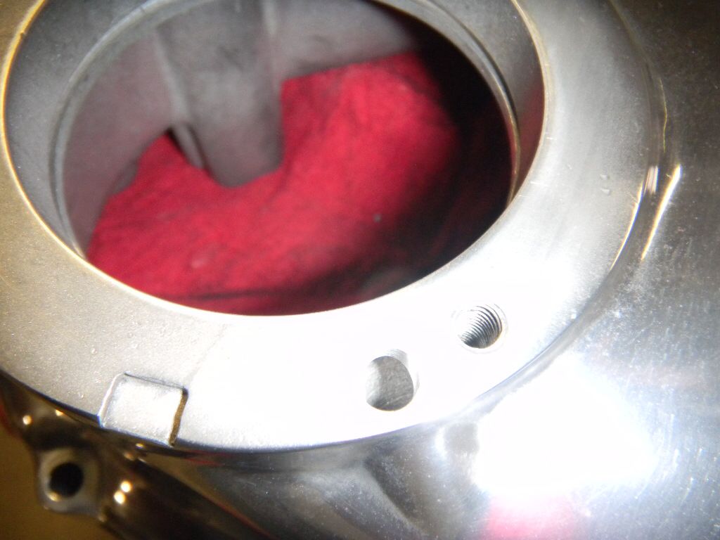

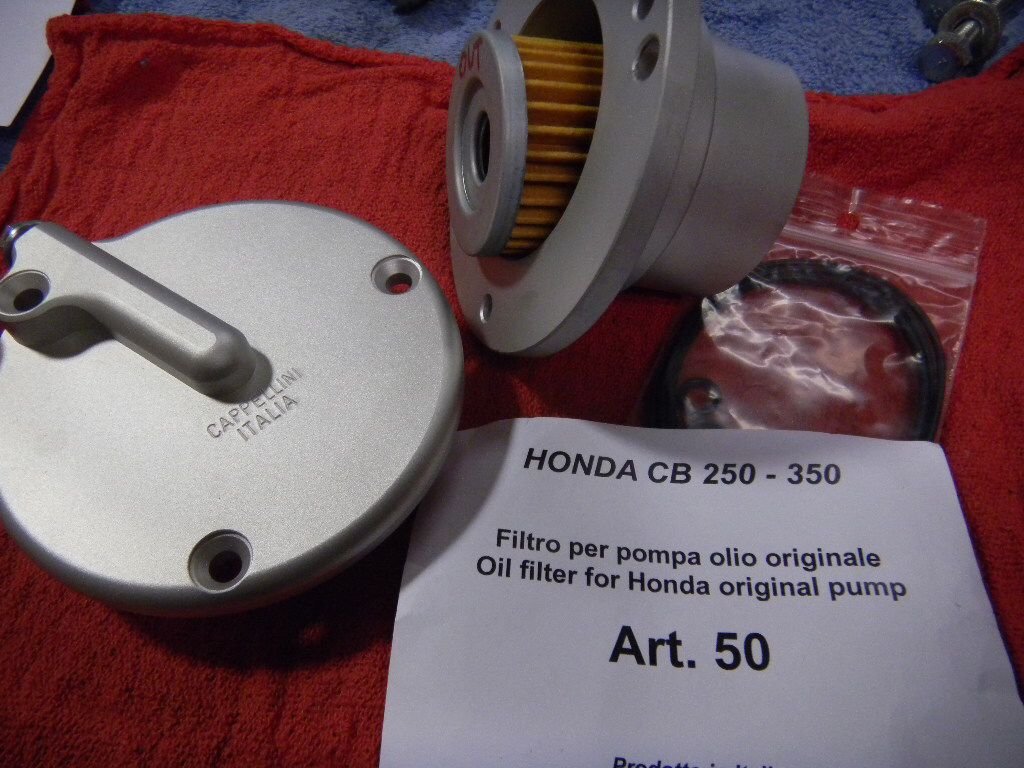

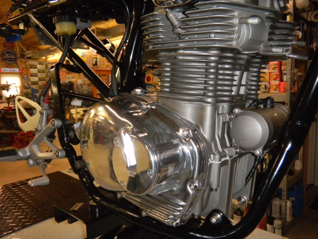

Went a different route with the oil filter. The stock unit is a centrifugal type.
Was never a big fan, so with some research; found this jewel!
It did require some minor modifications.
A hole had to be drilled in the side cover.
The stock filter had to be cut or machined down to 22mm. Makes room for the new filter, and acts as a spacer for the gears, washers and nut.
Here's a shot of it installed. Will probably polish it after the first oil change.

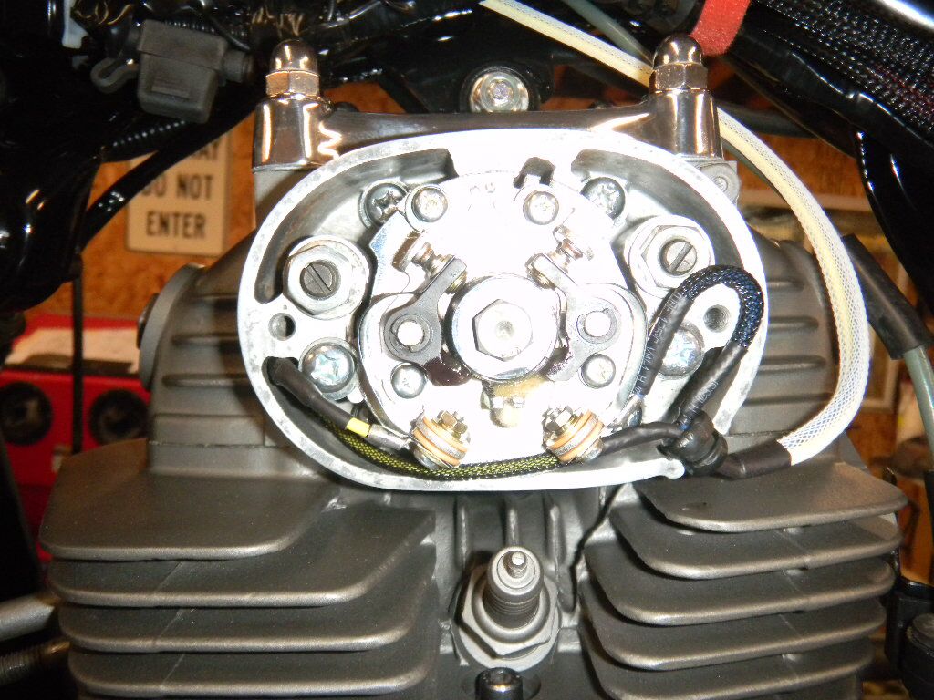

Cleaned & lubed the advance, installed the points, and wired them in.

Nice, an actual filter. That should be much better.
- Norbert R
- Posts: 1373
Re: '72 CB350 cafe "resto-mod"
Much better than the centifugal one IMO. Will look nice if you polish it after 1st oil change.

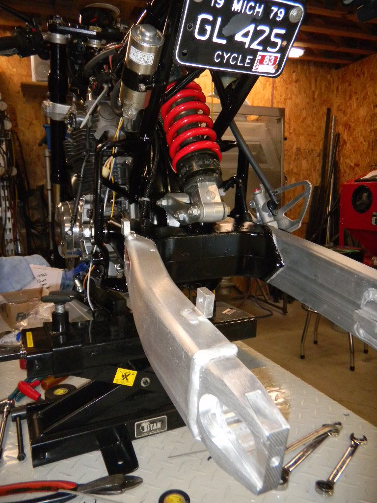

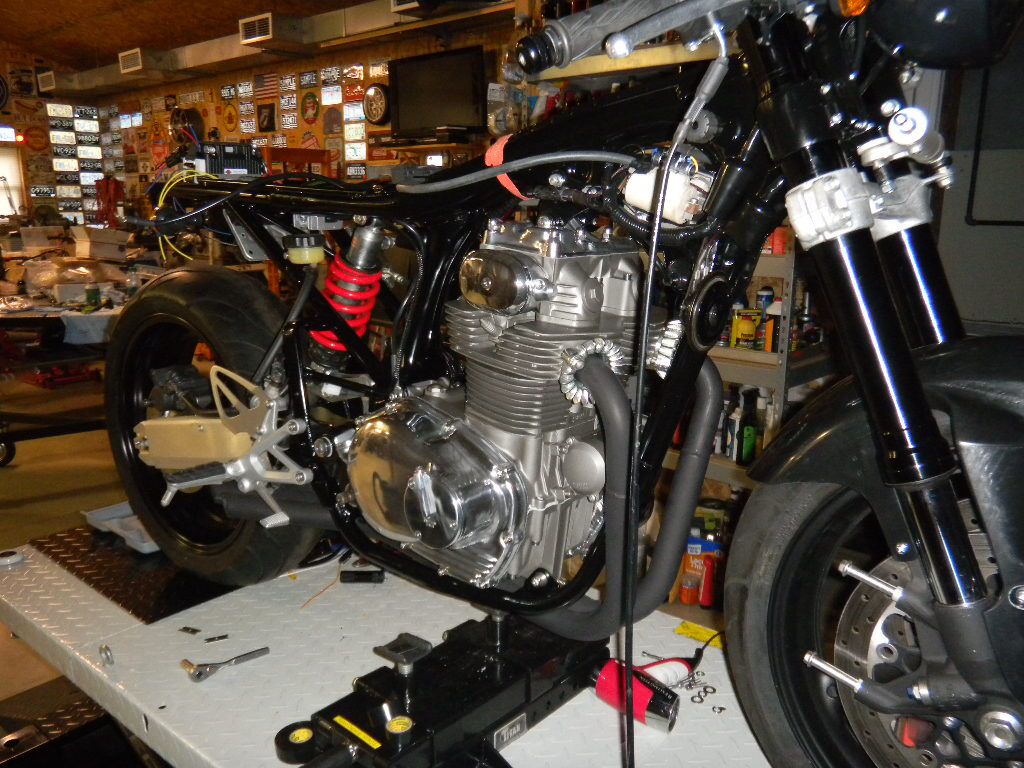

Some updates
Did the bling thing on the oil filter (thanks for the hint
Cleaned up the swingarm
Rebuilt the rear brake caliper & new wheel bearings.
Some updates

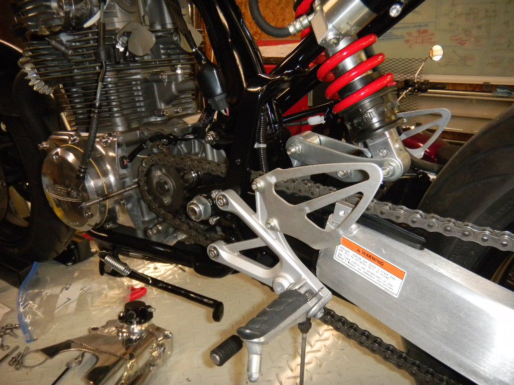

- luludog
- Posts: 573
- Joined: Fri Apr 13, 2012 4:16 am
- Location: Lawton, Michigan 49065
Thanks guys!

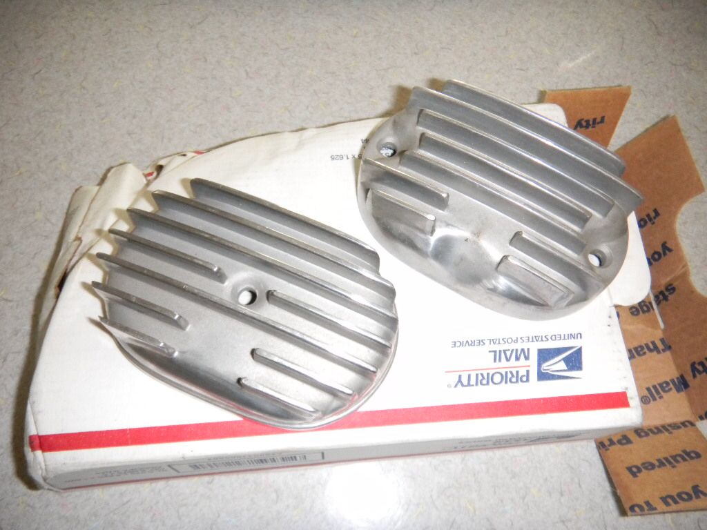

Found these

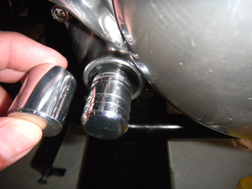

Won't be using the kick starter (for now. needs to be extended, more fab work)
Instead of leaving the shaft bare; made a couple of covers. Probably go with the right one.

Ray those finned cam covers are THE BUSINESS !!

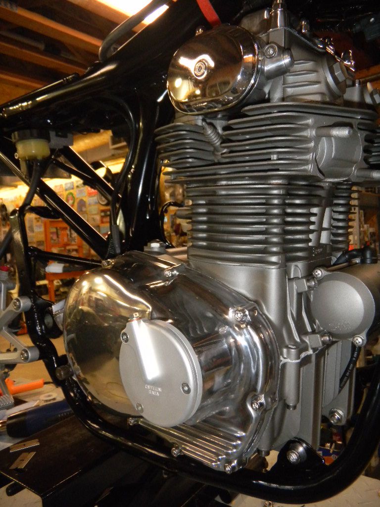

- luludog
- Posts: 573

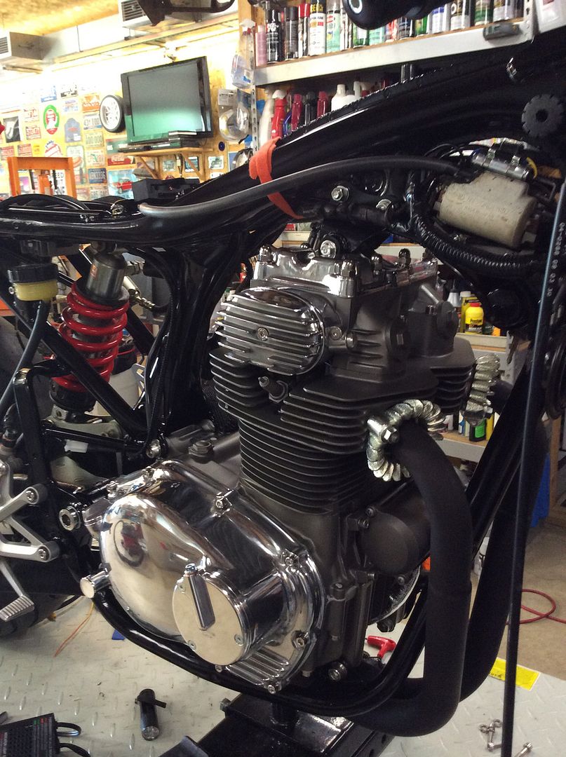

Thanks, really enjoying this project
Got a tip from one of the members on the VJMOG site. Contacted the owner, we agreed on a price, two days later they were in the mailbox. Very, very fortunate to have them!Norbert R wrote:Ray those finned cam covers are THE BUSINESS !!

- Norbert R
- Posts: 1373
Well you've certainly done them justice, motor looks fabulous with them on and all polished
