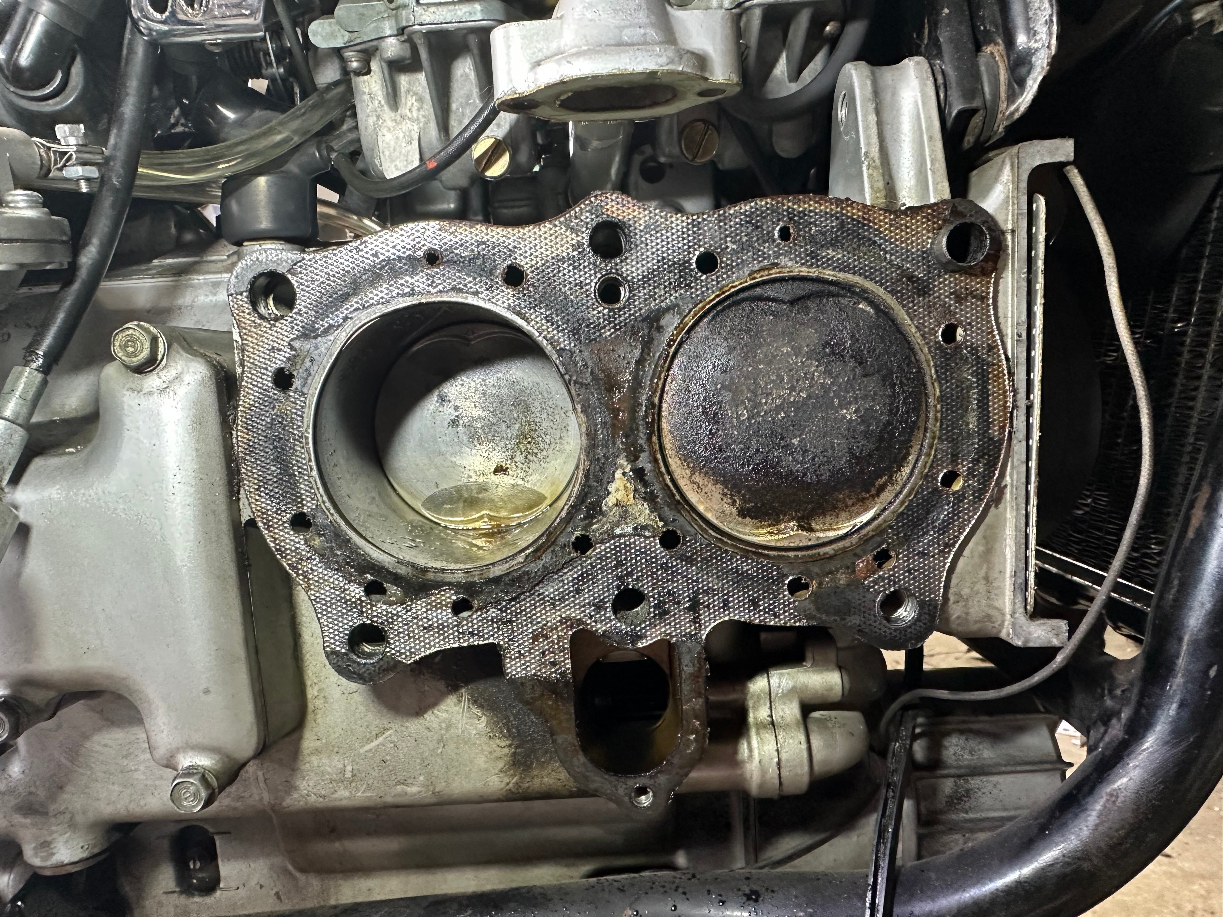

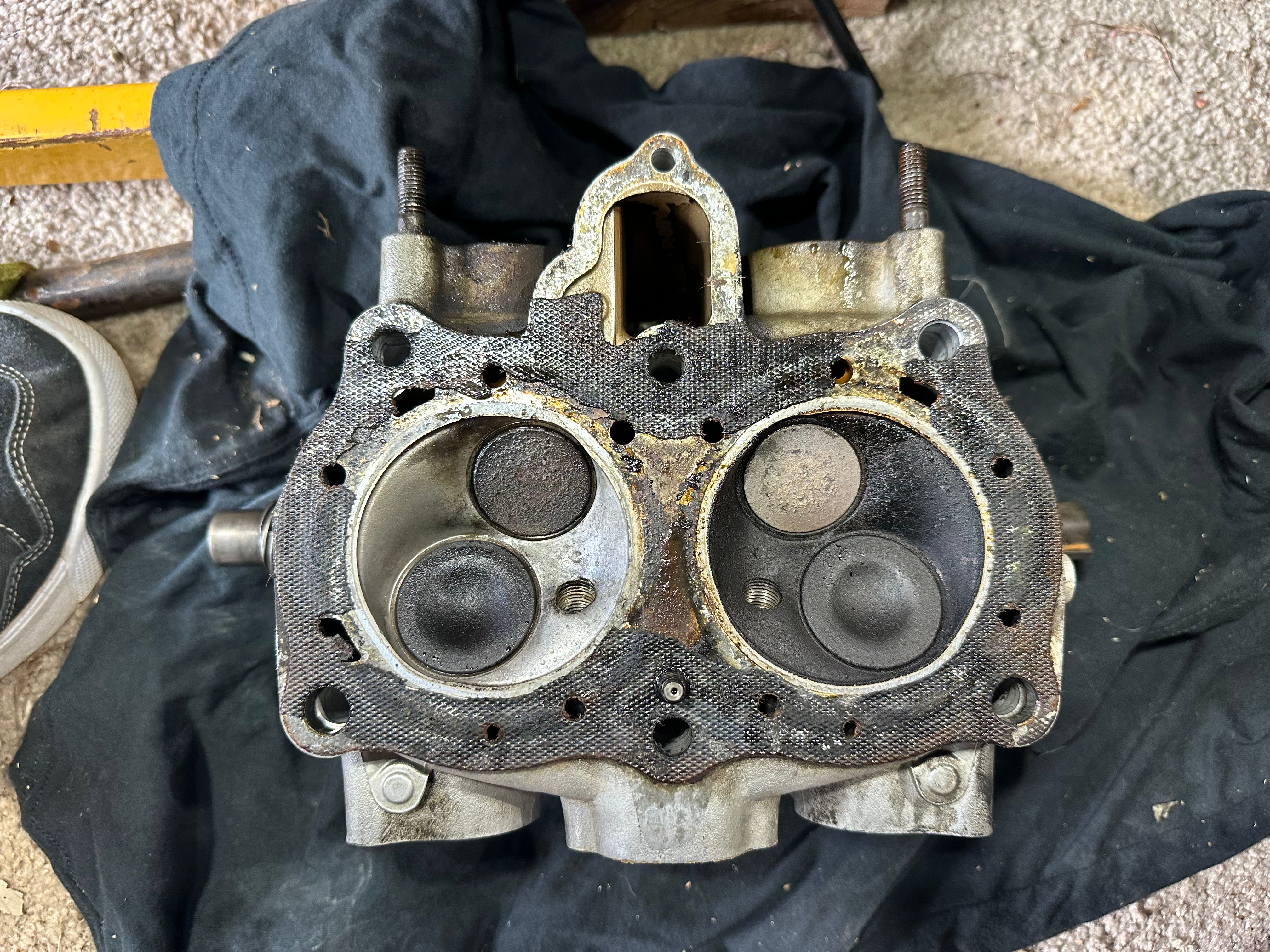

Got the head pried off and this is what I found
Obviously by the steam cleaned cylinder I was correct that #3 was the leaky culprit.

- Posts: 8249
Re: Dumb question: Removing cylinder head
Nothing out of the ordinary there, clean up and reassemble.

Yup. Only thing that jumped out of me was it was probably the read cylinder that blew the head gasket, huh? Coolant in the combustion chamber makes an excellent steam cleaner.
(Now'd be the time to do valve guide seals and a valve lap if you're so inclined, but not necessary if she ran good before.)

Yep, definitely leaking into the #3 cyl. Don’t loose that easy to misplace oil restriction (the little metal plug with the o’ring) you have to have it.
