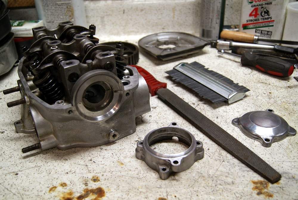

Note that I did not need to drill or tap any holes to make that work.
- The left head on a GL1100 has a steel cap to cover then end of the camshaft, which uses the same holes used for bolting the points case onto the 1000 head. Actually, you will find the same hopes on each end of both heads because they are also used for attaching the timing belt covers and the fuel pump.
- The GL1000 ignition plate that the points (or in my case the Dyna-S electronic ignition's modules) are mounted on is attached to the inside of the points case so the points case already has the holes for that.
You can see the holes that the points case bolts to on either side of the opening where the camshaft (not yet installed) will be in this pic
BTW, you should use the rockers that came with the cam you use and use the cam holders that came with the head.
And you want the left head and camshaft to match the right one.

Shes up and running with no leaks! Filed my ignition module's boss down like Sidecar Bob, it took a few rounds of filing and test fitting but it works great. Also, didn't realize theres a slight difference in the 1100 and 1000 heads so probably good that I have 1100 heads on both sides now.
