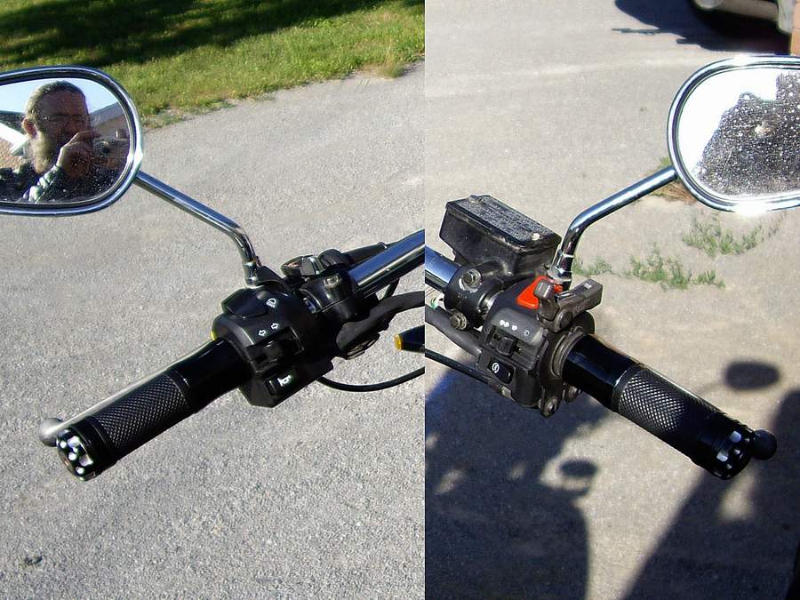

I've spent about half of the last 4 days modifying the switches to fit the 'Wing.
- I had already unsoldered the wires from the new switches when I took them apart last week so I started by cutting the wires off of the old switches and getting them ready for the new ones. They appear to have been hot glued together and to the plastic sleeves at the ends so I had to cut them apart and remove the glue residue with mineral spirits.
- Before I started soldering the old wires to the new switches I slipped a new piece of 3/4" black heat shrink over them but did not shrink it until all of the wires were soldered & the switches plugged in and tested.
- Rubbing compound removed the unwanted markings nicely and I gently buffed the areas to restore the original sheen.
- I drilled locating holes in the handlebar to match the pegs in the switch housings.
LEFT
- I had to file a little off of the back of the housing to clear the clutch perch.
- The choke lever required no modification. Even though the switch has a square hole, the original cable popped in place as if it was made for it. It didn't even need to be adjusted. I will worry about removing the original lever later.
- Since the new turn signal switch doesn't control the running lights I removed the wires for them from the connector. I added a piece of clear insulation speaker wire that is about the same gauge as the original wires and connected it to the passing light button for the garage door opener.
RIGHT
- I ran an M10-1.25 tap into the existing hole for the throttle cable. I found some 1/4" long pieces of 1/4" aluminum window frame in one of the drawers of shop stuff I inherited from my Dad that were the perfect size for the stop for the twistgrip. I drilled & tapped one of them for a #6-32 screw, filed the back of the piece a bit to fit the inside of the housing and chiseled out a flat spot on the housing for the head of the screw.
- I used a drill bit to make new markings for the headlight switch, a single dimple with a bit of white paint around the edge for OFF, a single dimple painted entirely white for DAY and 2 siamesed dimples painted white for NIGHT.
- I used the wires that originally went to the headlight contacts on the START button for the power (black/red) and bike headlight (blue/white) wires to the headlight switch and added a purple wire for the sidecar headlight.
I will post pics of what they look like on the bike later. This work is part of a larger project and I have to get it finished tomorrow so I can drive it to work on Tuesday.
Edit Sept 28 2013: "clutch lever" changed to "choke lever"

The finished product (well, almost - I will be mounting the new windshield this afternoon).
