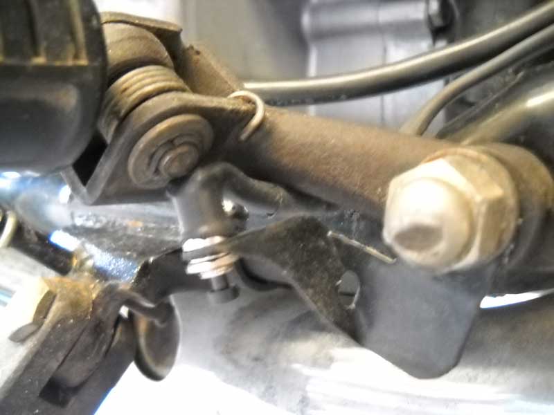

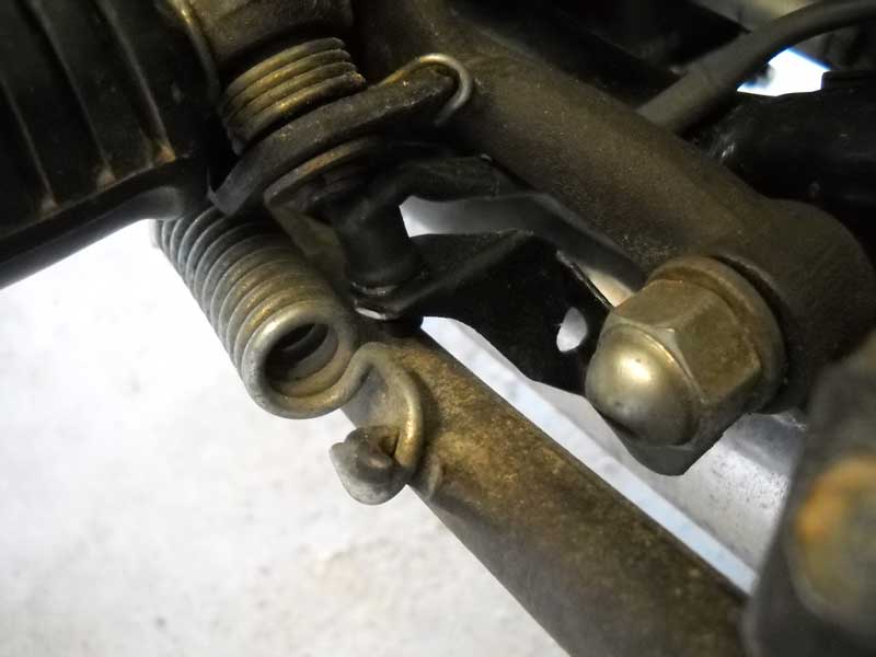

There are a few tutorials on equipping a bike with a side stand switch. I think the previous poster has one.
Re: The making of and transformation of "Murphy"
#41
Not much of a tutorial ... but here it is.
For safety's sake I just mounted a tiny switch down by the kickstand and a bright like on the handlebar bracket. The switch is attached to the left rider's footpeg.
Kickstand up:

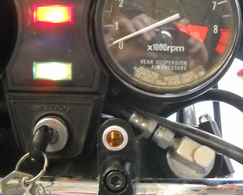

Light is off:

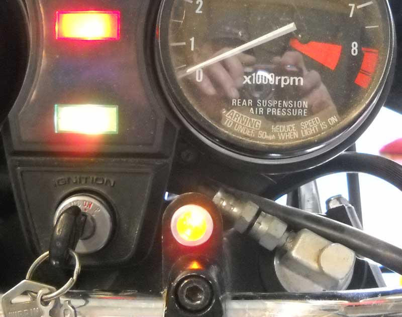

The light is mounted on the left handlebar mount. A simple, flat piece of aluminum is fitted to the top bolt.
Kickstand down (=DANGER!):
Light is on:
