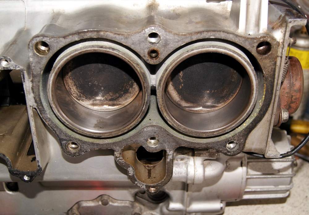

Piston in honing - advice before I start?
My buddy that grew up in the shop of his father's VW dealership (= he has had a lot more engines apart than I have) was here yesterday so I got him to have a look at it. He said if it was his engine he wouldn't hone so I'm going to leave it alone.
Cylinders #3 & #1. (the lines you can see in #1 are not very deep. Cleaning the cylinder out with Scotchbrite removed most of it.

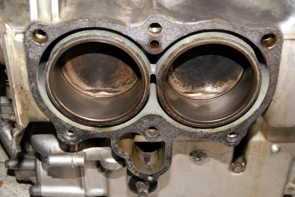

Cylinders #2 & #4

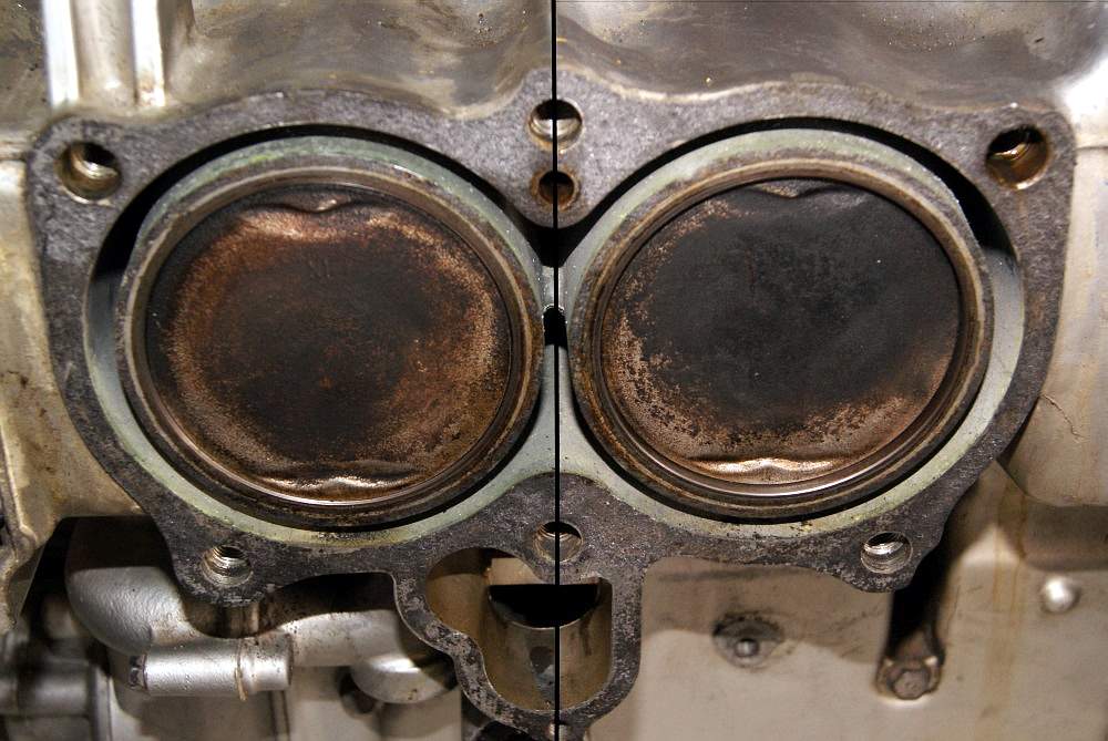

While we were turning the engine we noticed that #1,2&3 pistons are all flush with the mating surface at TDC but #4 is about 3mm below. This split screen pic shows the difference. Is this common or do I have a problem?
Posts: 21336
Re: Mr.H's new engine
Hmm, I don't remember my pistons doing that on my 81...
Posts: 25186
Ya, almost sounds like a bent rod
salukispeed
Posts: 1951
Joined: Sun Feb 21, 2010 10:08 am
Location: Oak Forest Illinois US
Post by salukispeed »
That would be the symptom of a hydraulic-ed issue some time in its past and a bent rod seems possible.
Honda 72 CL100 sold
74 CB750 K4 nice driver
1966 CA77/305 Dream nostalgic driver
84 GL1200I work in progress
1970 CT 70
1982 GL500 Interstate
JBz
Posts: 3070
Joined: Wed Jan 31, 2007 8:11 pm
Location: dayton nv
Post by JBz »
that's quite a bit 3mm. #3 cylinder doesn't look good to me............jb
Posts: 38157
That would be a cause for significant concern for me.
ericheath
Posts: 9617
Location: Winnipeg, Manituba
Post by ericheath »
That's what happened to my 85 engine when it hydrolocked. I did not even notice it happened except for a little more vibration and a slight loss of power. I only found it because it blew a head gasket. From the way mine rode, I'll bet there a few others rolling around and don't even know they're bent.
Posts: 21890
That is a bent rod. I had one here about 2 years ago like that. Ran, but as the guy rode it the engine started to make noise. It will just keep getting worse if you run it.

+1 with Robin on the bent rod. Not even sure if you can buy rods and bearings any more. Maybe look for a different engine.

Look at the bright side.... Now you know how to clean and paint one. I'm wondering if that much of a bend in the rod would have shown up with a compression test.
