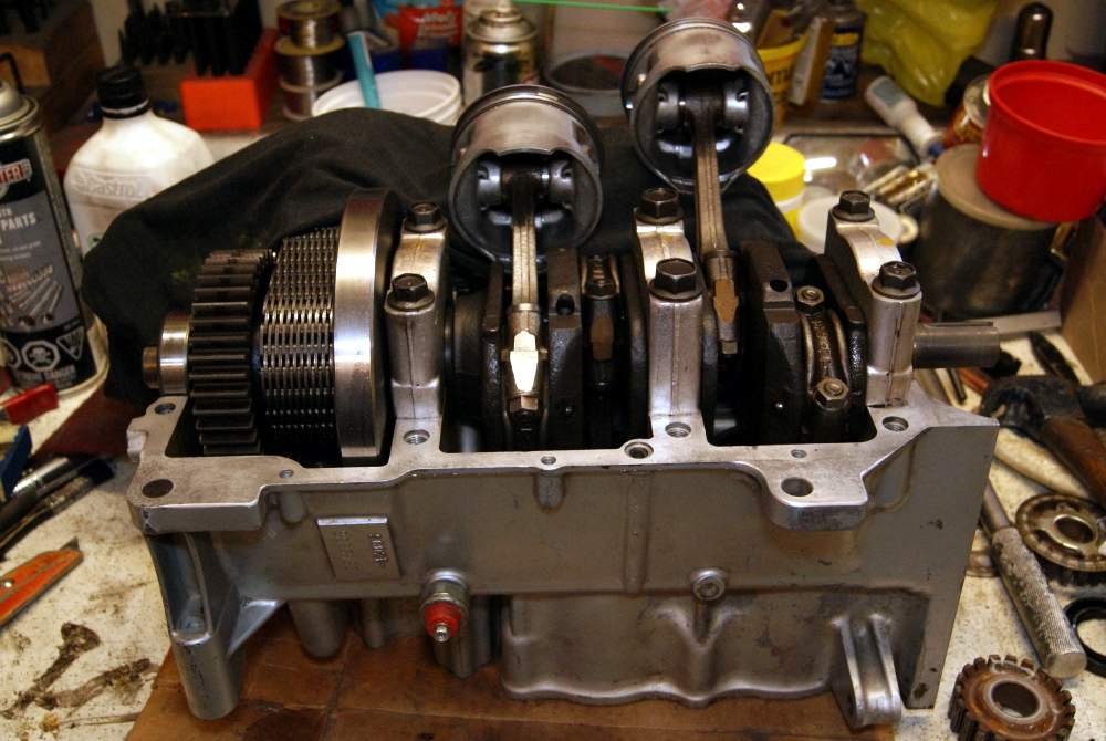

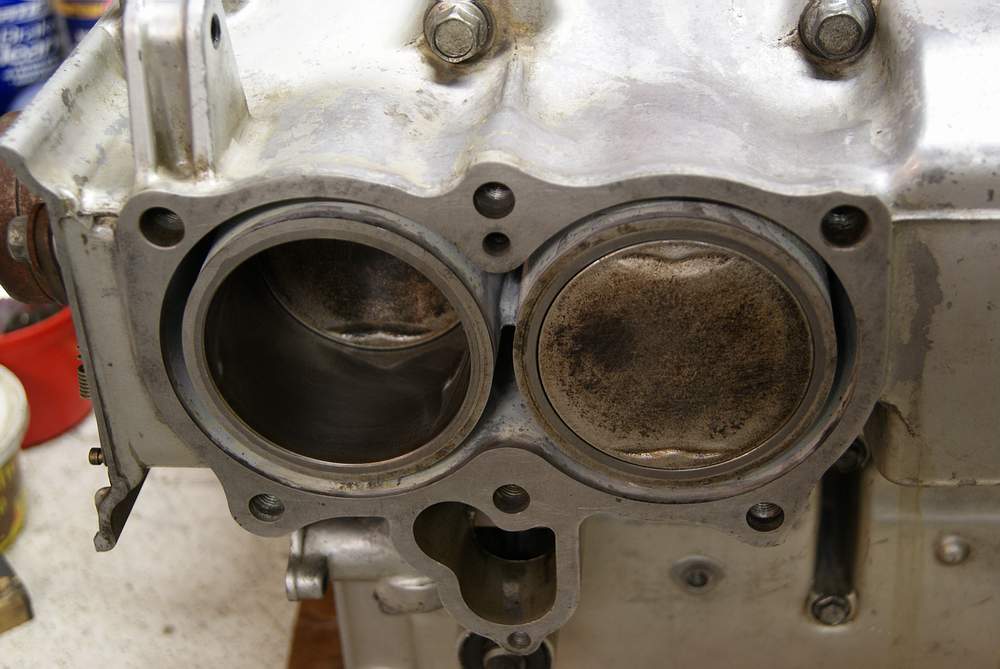

Not much time in the shop today
And just to confirm: #4 at TDC with the new rod (it was about 3mm below the mating surface with the bent rod)
BTW: In the early part of this thread someone mentioned finding someone with a press to put the piston onto the new rod. I did it by heating up the small end of the rod with a propane torch to expand it so that the wrist pin slid in without force.
Shadowjack
- Posts: 717
- Joined: Fri May 26, 2017 11:07 am
Re: Mr.H's new engine
Production engine shops have a special little small-end heater for that specific task.

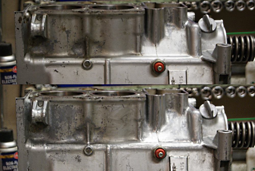

I started cleaning up the outside of the block so I can do the places that will be hard to get at when everything is together. Among other things, I have noticed that this engine's castings are a lot rougher than either of the 1000 engines I have so I have been filing & sanding the rough/sharp edges, mould lines and flow marks. I'm not trying to make it perfect (most of the rough bits will be behind or under other parts anyway) but just to make less sharp edges and places for dirt to collect.

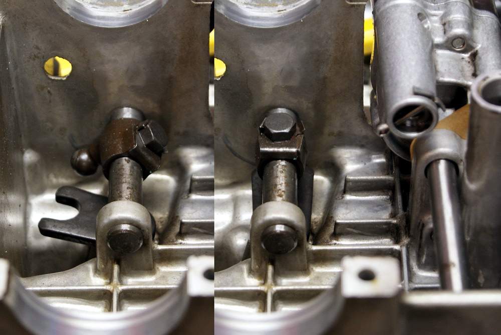

AAAaaarrrrrggghhh!!!!!
I just decided to make sure my neutral switch is working (it is now that I've figured out that it is on when the long end of the pin is lined up with the tab) and realized that the gearshift shaft isn't engaged with the mechanism properly. The shaft moves about 45 degrees without moving the mechanism
After studying the FSM I think the dogs on the shift shaft have become disengaged from the shift arm. This should be an easy fix but I think I'll have to split the block again to do it. But I'm about finished working for tonight so that will have to wait until tomorrow...
I'm glad I didn't start bolting the rear cover on before I discovered this
BTW: Note to self: It will be easier to align the neutral switch if the transmission cover is put on with the engine upside down.

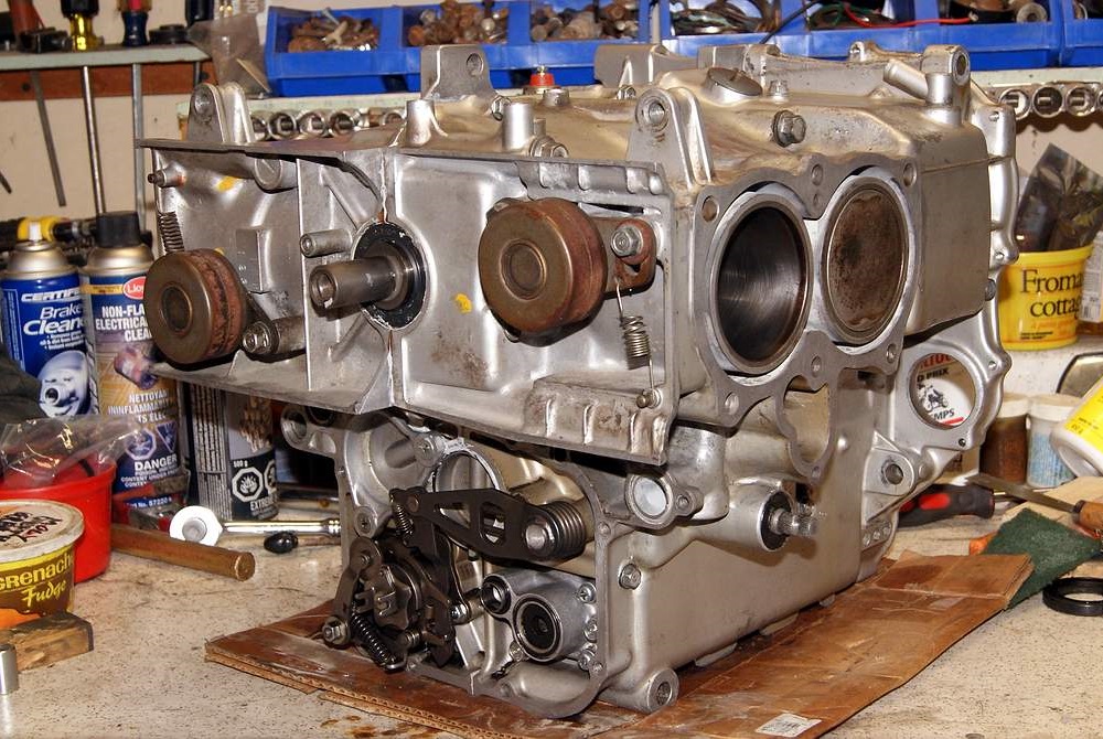

- Sidecar Bob
- Posts: 8235

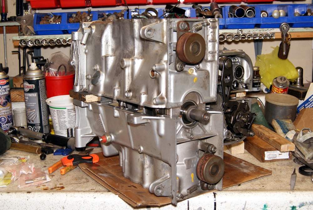

Today I finished filing & sanding rough edges and then split the block again. I don't know how well you will be able to see in the pics but on the left is what I found and on the right is the way it should be. The forked part is on the end of the shifter shaft and the shaft you see is the one that is attached to the shift arm that actually changes the gears. The part with what looks like a ball on it is supposed to be between the forks so that when the shift shaft is rotated the forks push the "ball" so that the shift arm shaft rotates and the gears change.
The block is back together again with a the gearshift functioning properly and all it cost me was some time and a bit of ThreeBond (I still have only used a small percentage of the new tube I bought for this project).
Since I have to wait for the water pump parts I'll start putting the stuff at the back end of the engine on next. I'm not in a rush to get it finished as long as it's assembled and ready to paint by the time it is warm enough to paint with the overhead door open (probably late April).
BTW: Since I changed the choke lever I barely have to touch the Start button and it roars to life. It's almost a shame to replace that engine but it really needs the lower overall gearing and besides, the old engine has gone well over 150,000 Km (this is the 3rd bike it has been in so far) and the only times it has been apart were to replace the water pump and a couple of head gaskets so it must be getting tired.

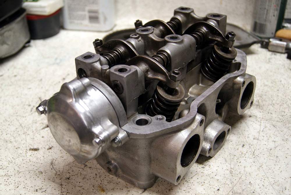

The seal came and the springs are waiting for me to pick up (probably tomorrow).
When I took the sheet metal cap off of the rear end of the left head I realized that the place where the points case bolts onto the 1000 head has a straight sided recess for the shoulder on the case to fit into but the on 1100 head the opening has a shallow bevel so I started a thread to ask about it but with no definitive answer and the guy that did this before no longer on the forum I decided I was on my own.
To make it fit right I would need to change the shape of either the opening or the case. Since the case would be cheaper to replace if I screwed it up I decided that was the best candidate for modification. So I spent a quiet hour in the shop with the case clamped in the vise (with the soft jaws) bevelling it with my aluminum file (if you don't have one you probably need to get one), then going over it with a finer file, smearing marker all over it, rotating it in the hole to reveal the high spots (surprisingly few) and finally sanding it smooth.
BTW: The angle is approx. 45 degrees and I figured out quickly that if I filed into the shoulder and about 0.5mm from the inner edge it would be perfect.
And here it is bolted up.
I made one mistake: I should have left a tiny bit straight next to the shoulder to allow for the gasket.As it is it fits close enough to perfectly without a gasket but there is a lot of play if I put the gasket between the case and the head. I think I'll cut a ring of gasket material, wet it and loosely bolt the parts together so that it will form into the correct taper and pull the case to centred over the opening. Come to think about it that might be better than if I had left room for the gasket anyway.....
- Posts: 9617
Looks great and well thought out. Looking forward to hearing how it works. A picture is worth a thousand words.
