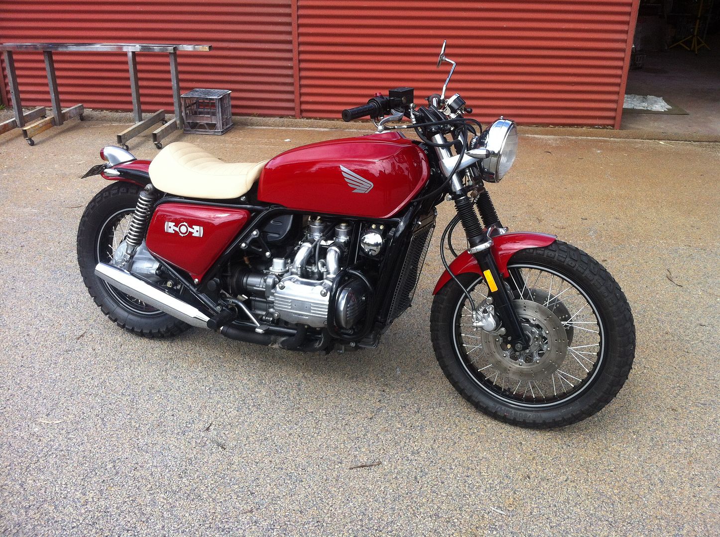

I went to the local Harley mechanic and asked for "Shorty" mufflers... He had several different type (internally) and i chose the set with the biggest bore and following his instructions knocked out a washer type restrictor that was tacked welded in about 8 inches from the exit,,, Great quality chrome, as new Au$100 i was happy for that price...

olchris wrote:I went to the local Harley mechanic and asked for "Shorty" mufflers... He had several different type (internally) and i chose the set with the biggest bore and following his instructions knocked out a washer type restrictor that was tacked welded in about 8 inches from the exit,,, Great quality chrome, as new Au$100 i was happy for that price...
Those are exactly what I want for mine and your bike looks amazing

These look good to me on a stock machine.

I agree, those look outstanding! A sportster muffler?Gowing wrote:These look good to me on a stock machine.
