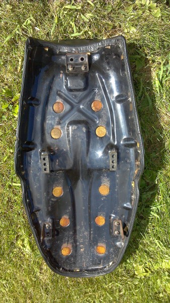

As stated, all 1975 through 1977 seat pans are identical. To be more specific, all 1975 though 1979 seat pans are identical and can be used to rebuild a seat from any of those years. Any 1975 through 1979 seat will bolt on to, and fit, any 1975 through 1979 GoldWing.

As stated, all 1976 LTD through 1977 seat pans are identical. To be more specific, all 1975 though 1979 seat pans are identical and can be used to rebuild a seat from any of those years. Any 1975 through 1979 seat will bolt on to, and fit, any 1975 through 1979 GoldWing.

As stated, all 1978 and 1979 seat pans are identical. To be more specific, all 1975 though 1979 seat pans are identical and can be used to rebuild a seat from any of those years. Any 1975 through 1979 seat will bolt on to, and fit, any 1975 through 1979 GoldWing.

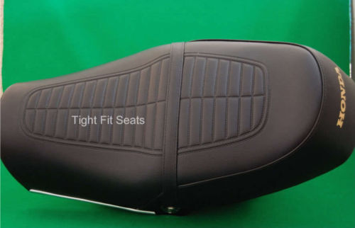

There are sellers on eBay that offer nice looking seat covers that closely resemble factory originals. Below is an example of an eBay cover placed on an existing pan and foam base. Also, searching eBay will produce sellers who offer repair parts for your existing seat e.g., reproduction seat straps, buckles and lower trim pieces. For the often missing pan parts i.e., the front and rear stays (or mounts) and the rubber bumpers, only the rubber bumper pads are (currently) available from Honda. The front and rear stays must be found on eBay or via a generous club member.
