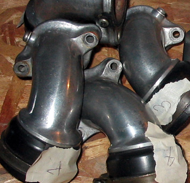

The first thing to do is to peel off the tape labels and do some etching. I scratched a number on the inside edge of each one. But, I got my carb kit today from Randakk and Howard Halasz tells of a better way in his excellent GL100 Repair Guide. His idea is to put a punch mark on #1, two on #2, three on #3 and none on #4 (4's the one w/none). Cool. Next time, that's how I'll do it. Thanks, Howard.

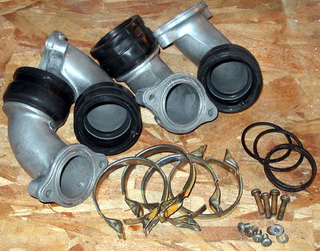

Clean the parts with Mineral Spirits and lots of rags and it's off to the wheel.
Here's everything all clean. I went at the screws and clamps with WD-40 to clean them up.

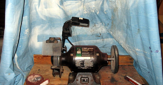

The buffing wheels are layers of cloth that are sewn together. When you use them, clouds of fine particles will fill the air. Wear a mask.
I built a mini enclosure to contain some of it.
My carbs were in the same space, partially open, so I covered them tightly with a drop cloth.

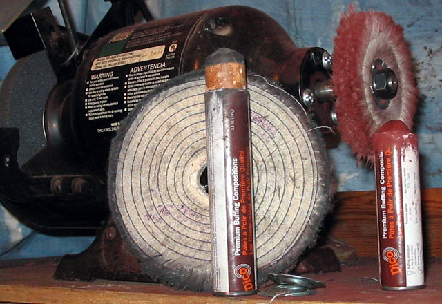

Here are the wheels and paste that I use.
The grinder and the finish (red) wheel is from Harbor Freight. Cheap. The firmer wheel and pastes are from Ace Hardware. Start with WR1-White paste and finish with JR1-Jewelers Paste. The white wheel is firmer and has extra stitching. Always think of these as sets. Don't put the wrong paste on a wheel or you've just trashed it.

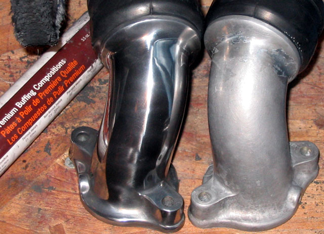

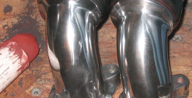

Here's the result on the first intake after about 5 minutes with the white wheel.
Then I did about another 2 minutes with white on that one to get an even finish. Then the white wheel on the other three and switched to the red wheel with Jewelers paste.
The one on the left below shows the result of 5 minutes with the red wheel.

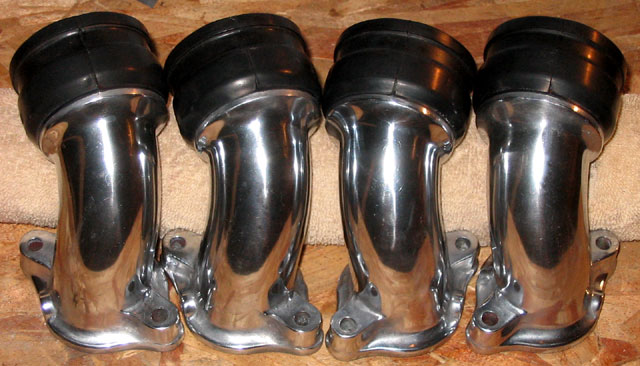

Rub on some Simichrome polish and you're done. Repeat the polish at least every six months. Like, on the spring day you'd planned to ride and it rained and on the fall ride day when it snows. This does not apply to you guys in the desert, of course. Your stuff don't corrode, does it?
And here we have the shiny bits all lined up and ready to go back on the bike. After the carbs have been Randakk'd, that is.
