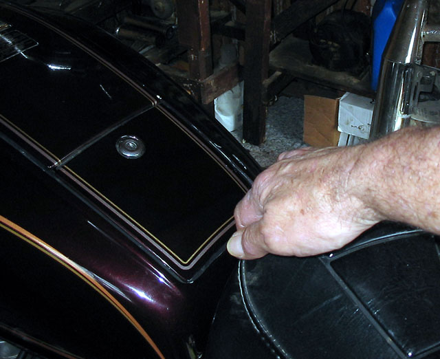

Get the Seat Off
1. Remove the 6mm Allen bolt on the right and the 8mm Allen on the left. There's a spring and adjuster handle on the left. Take out the bolt and spring and let the adjuster fall out the bottom. Put these parts in your bin #1.
2. Grab the front of the seat and slide it to the rear. Then lift the front, push it forward and lift it off. Stow it someplace safe.
