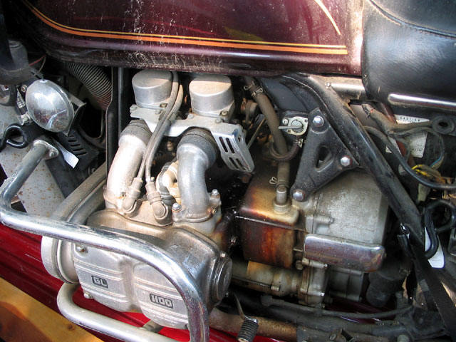

Here are some shots of the bike when I got it home.
It sure filled up the Nissan!
There may be a bit of varnish hiding somewhere.
That white Windjammer sure are ugly.
Gotta like the freebie collection, too.
I haven't figured out gender yet ... she ... he ... it? We'll have a bath tomorrow and should know by then.

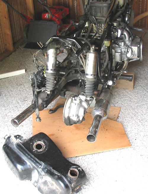

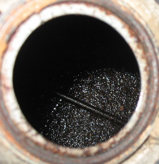

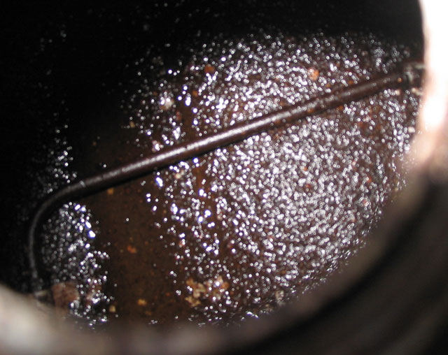

The gas tank is OUT!
It took 1-1/2 hours, but the tank is out. Now that I get a good look at what came out and what's inside, I don't think it's rusty. Maybe just crusty.
What do you guys think?
