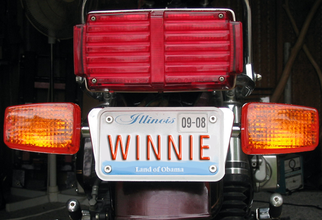

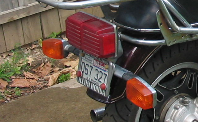

I never liked the big rear signals sticking out on Winnie's rear end like Prince Charles' ears.
So, I narrowed them with the help of a very creative buddy down at work.

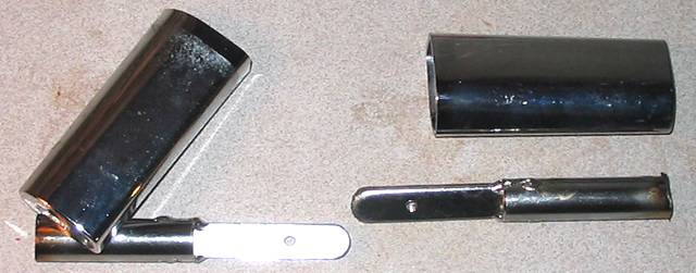

Here's the pieces that won't be going back on.
We cut off the mounting pipe flush with the body of the stop light housing. Then, he cut a piece of steel the same size as the pieces that were welded in and tapped new set screw holes. He also tapped a hole in the pipe on the inside of the housing for a set screw to hold them level.

Looks good, did something like that to my '77 to make way for saddle bags.Image

Same thing on my black bike. It think it looks much better than sticking out like Your Prince's ears. On the 78 it was very easy just use a set of the front blinker stand offs instead of the 4 inch jobbers that go in the back.
