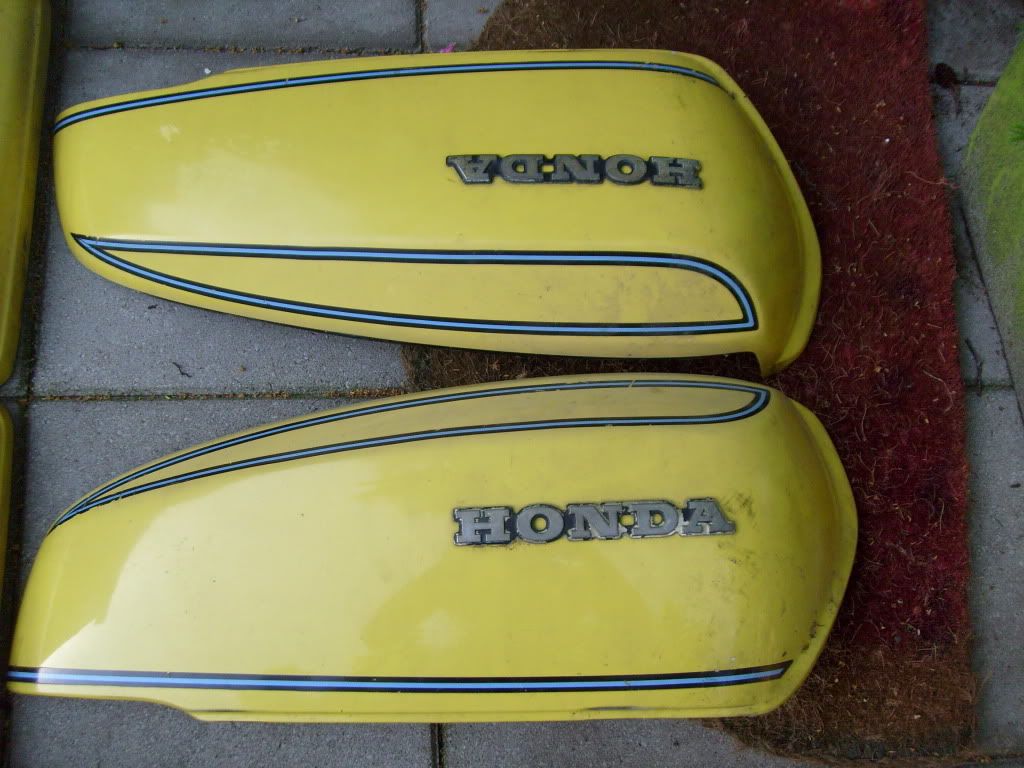

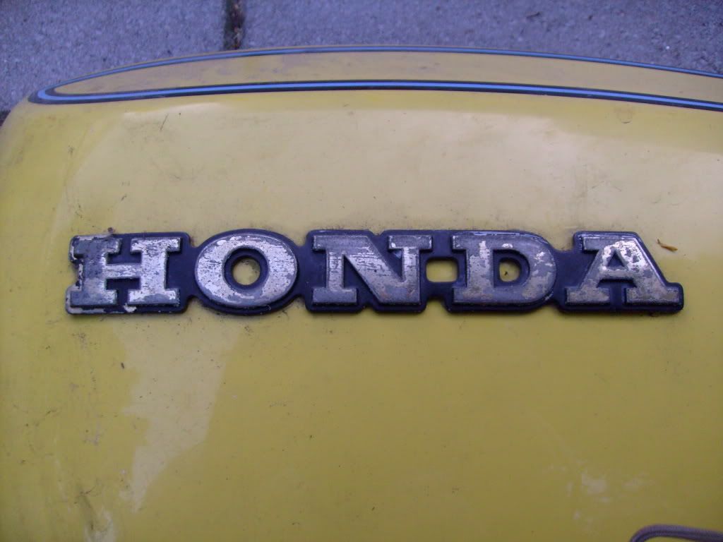

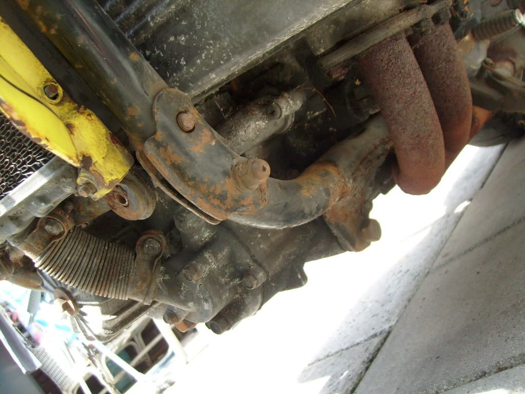

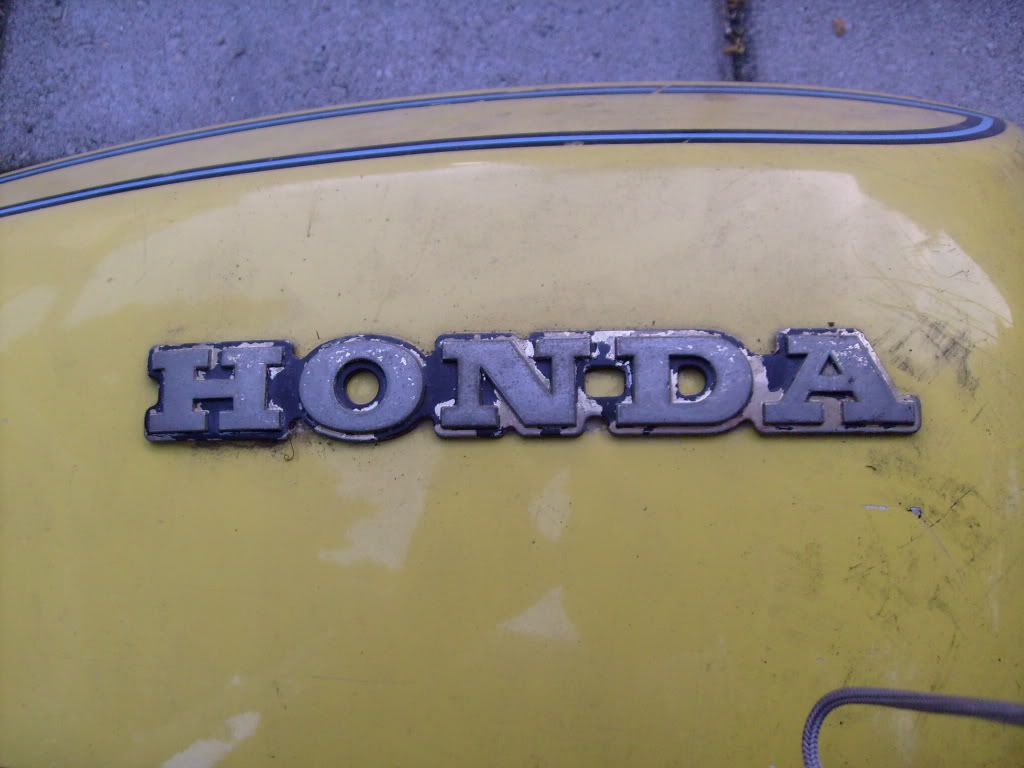

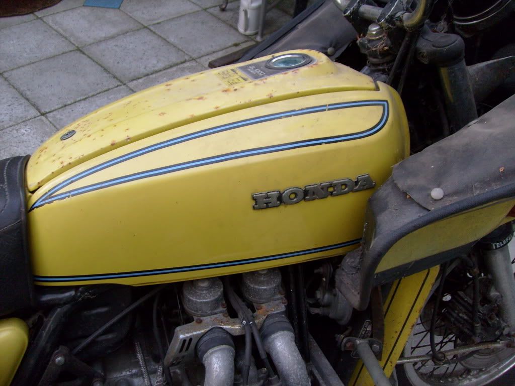

Hello guys,

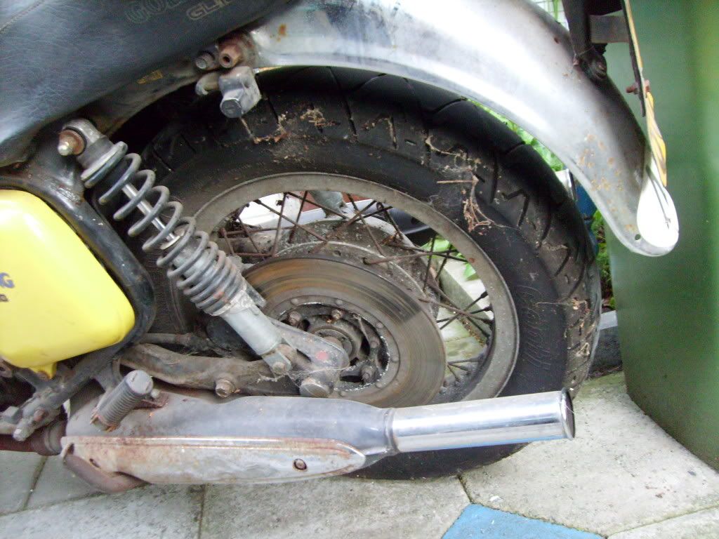

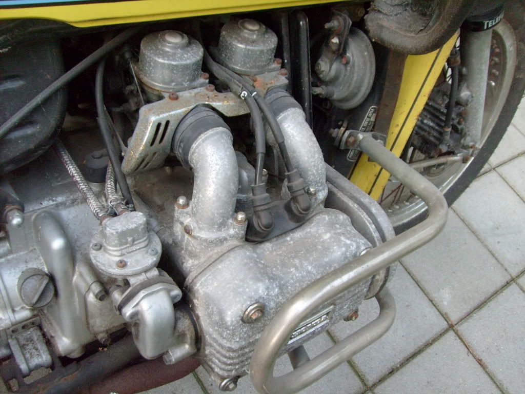

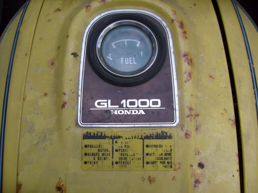

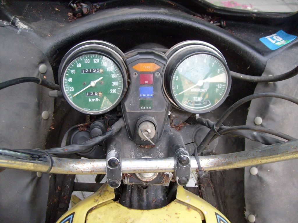

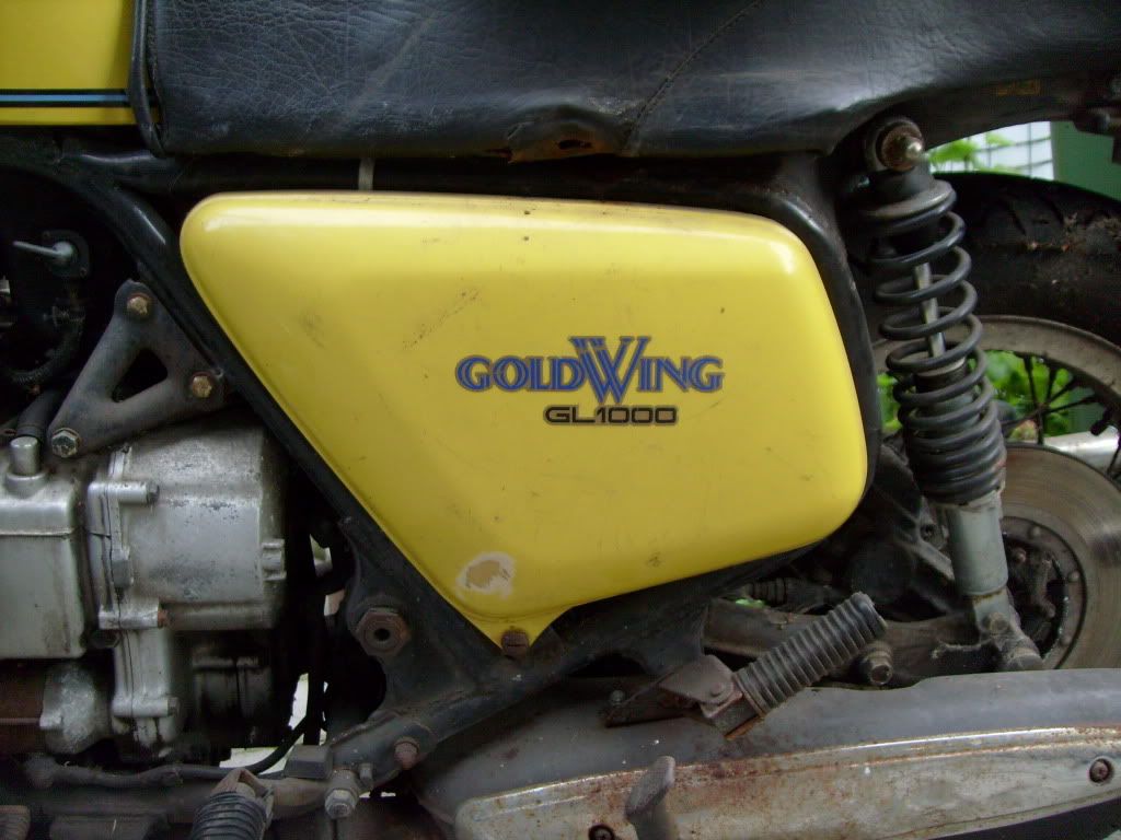

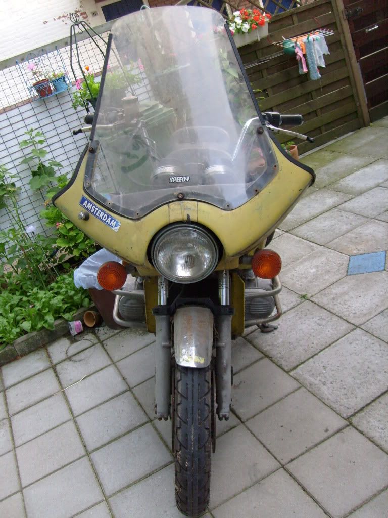

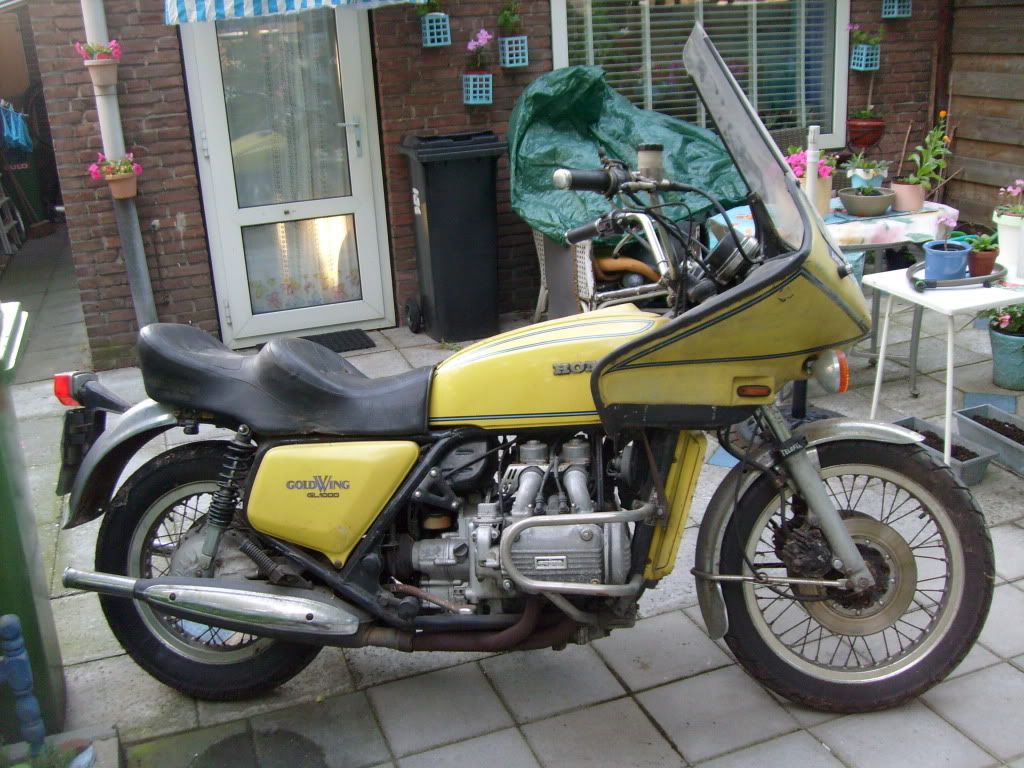

Here are some pictures of my Goldwing, still with the spiderwebs and other pieces of nature on it.
I bought it for 400 euro which is in our minds just like 400 dollar :P
Tell me what you think of it, the rust and mabye there are some parts on it which are not original.
Greetings

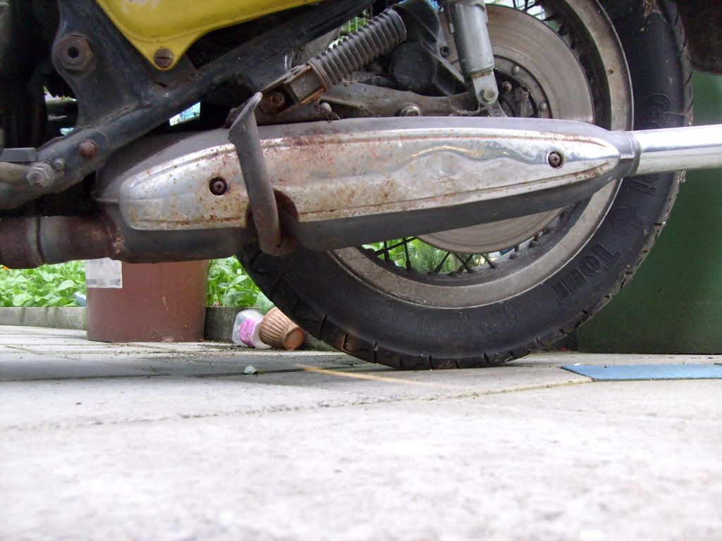

Re: Dutch guy with his 1976 Honda GL1000 in Sulfur Yellow.
Post by achmedachmed »

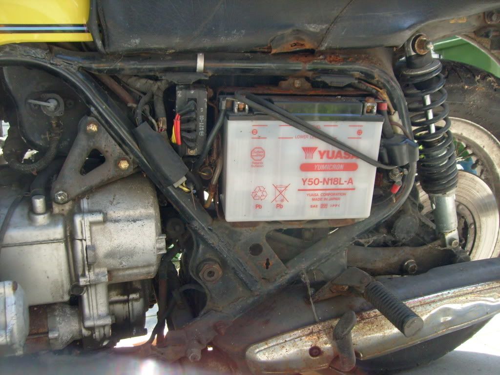

Some other pictures.. and yes I pushed the bike on foot to my place, according to the controls it was around 4 miles. Pushing a bike of 270 kilograms :mrgreen: Took me an hour!!

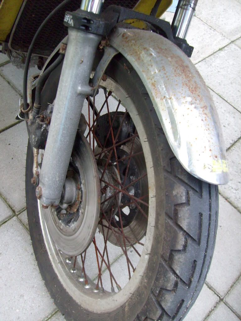

What would you guys do with all the rusted parts, like spokes, nuts and bolts? wheel wire them, use reverse electrolysis. Then polish it or buy new ones?

The seat isn't original and WD-40 won't do a thing to loosen a frozen bolt, its not made for that. Find a product made specially for loosening rusted, frozen bolts. A good product here is PB Blaster but I don't know if its available there. Another thought is to make your own using ATF and Acetone. There are a couple of threads on here that describe the proportions.

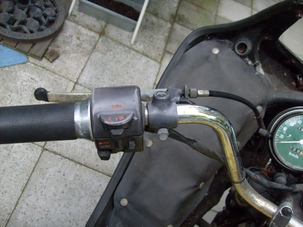

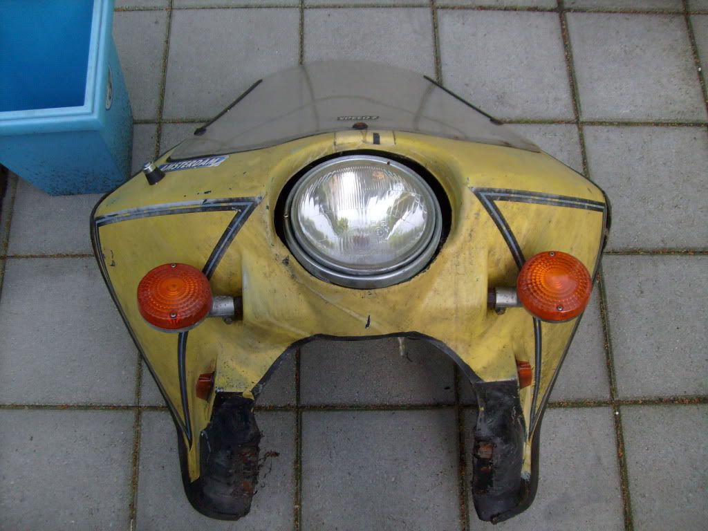

Lucky you! A '76 Yellow with only 12000km!
Bike looks good, only the seat, hand grips and fairing appear not original, and you are missing only the grab bar for the seat, mirrors and rear signals to bring the bike back to original.
(The original headlight bucket and headlight mounts might still be on the bike behind the fairing...yes, I can see just a little of one of the headlight mounts (the left) in your pictures...so you might just need a headlight unless it is still there as well.)
You are going to love this bike. I also changed from CB750 to Goldwings...you'll like the extra size and power... and Amsterdam is a beautiful city to own a bike!

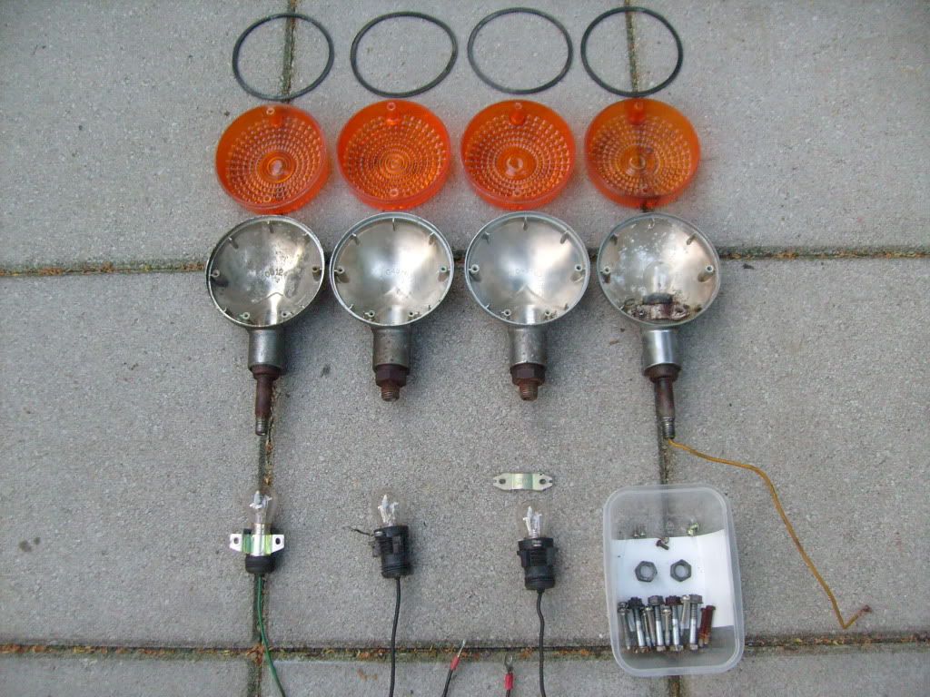

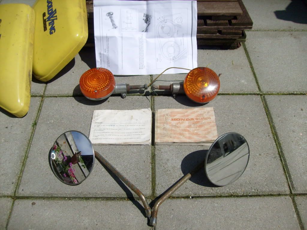

Quess what I found? The missing rear signals and the mirrors + a dutch AND international maintenance booklet from 1976!!! It was inside the big yellow windscreen thing :P The guy from whom I bought it didnt even know. I got it for less because of these missing parts.
The inside of all these signals was 'UNIQUE' missing screws or parts + glue

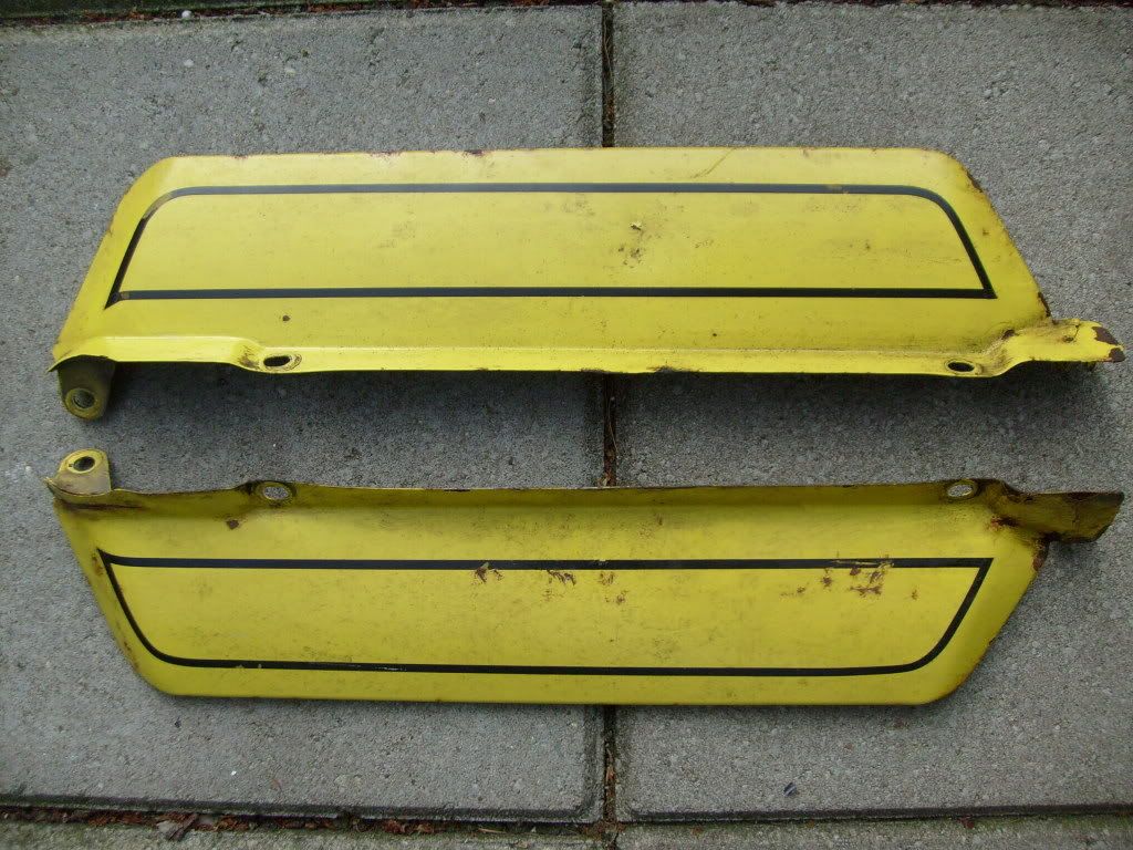

Should I sand the metal parts like, Yellow radiator sides and upper tankplate to bare metal? or just a smaller layer with the rusted parts?

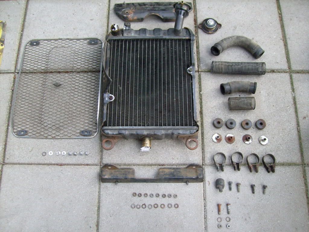

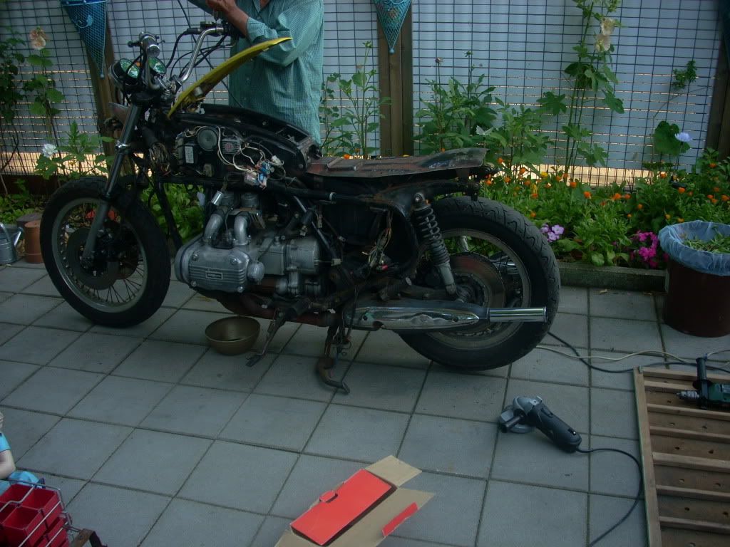

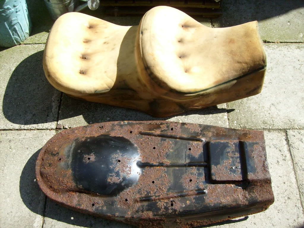

I am still busy stripping the bike, taking my time checking even the tiniest screws :mrgreen: , no need for a rush. I really enjoy every second of it. Cleaning parts takes the most time. The bike is not that rusty as i first thought it was, most comes of with a steal brush, only the seat and batteryholder are harder to de-rust

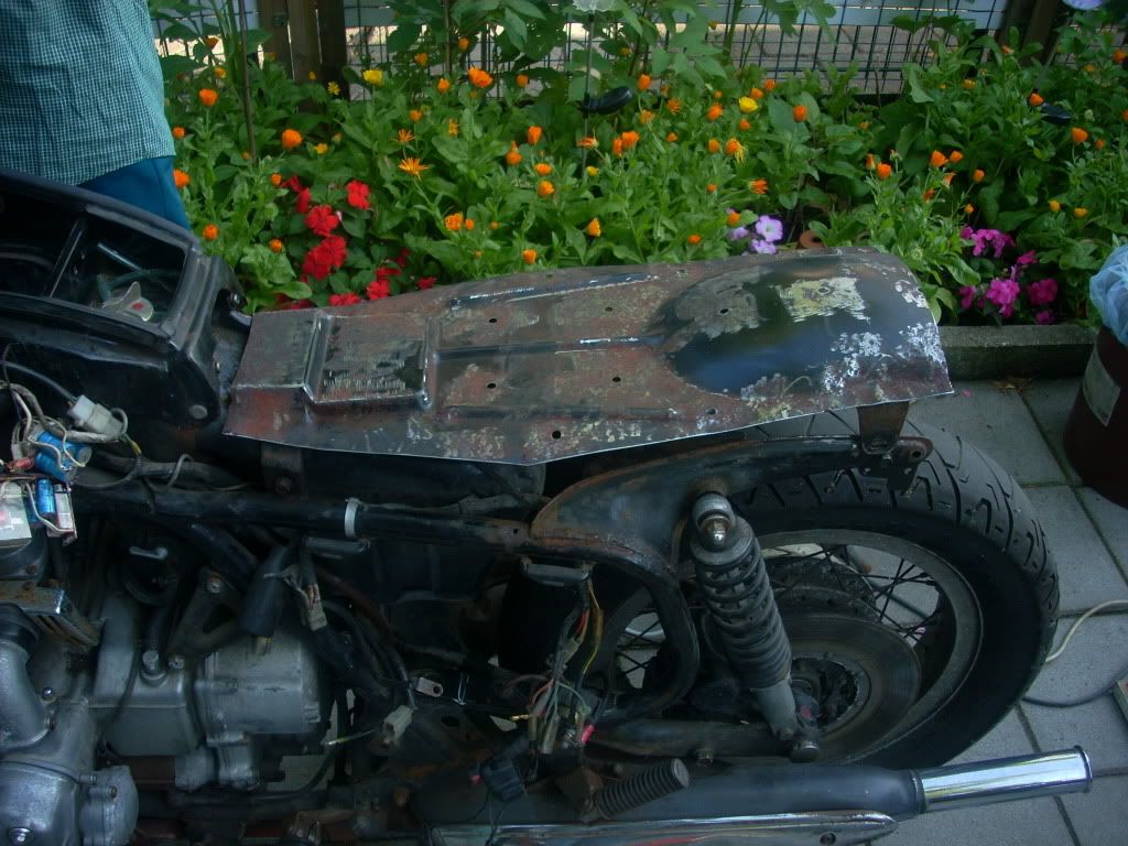

I cut most of the rusted parts away from the italian made ''Gullari something'' seat plate to something I liked for a new seat.

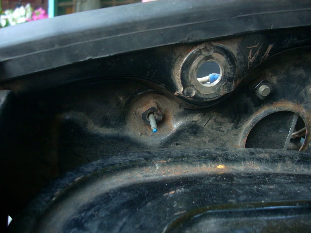

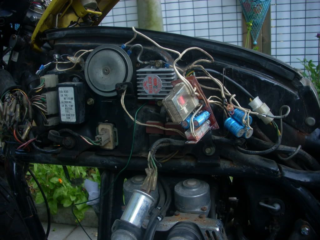

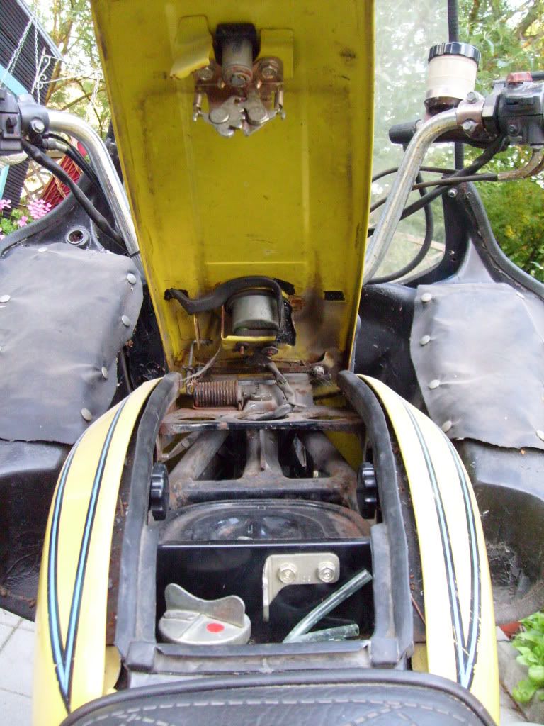

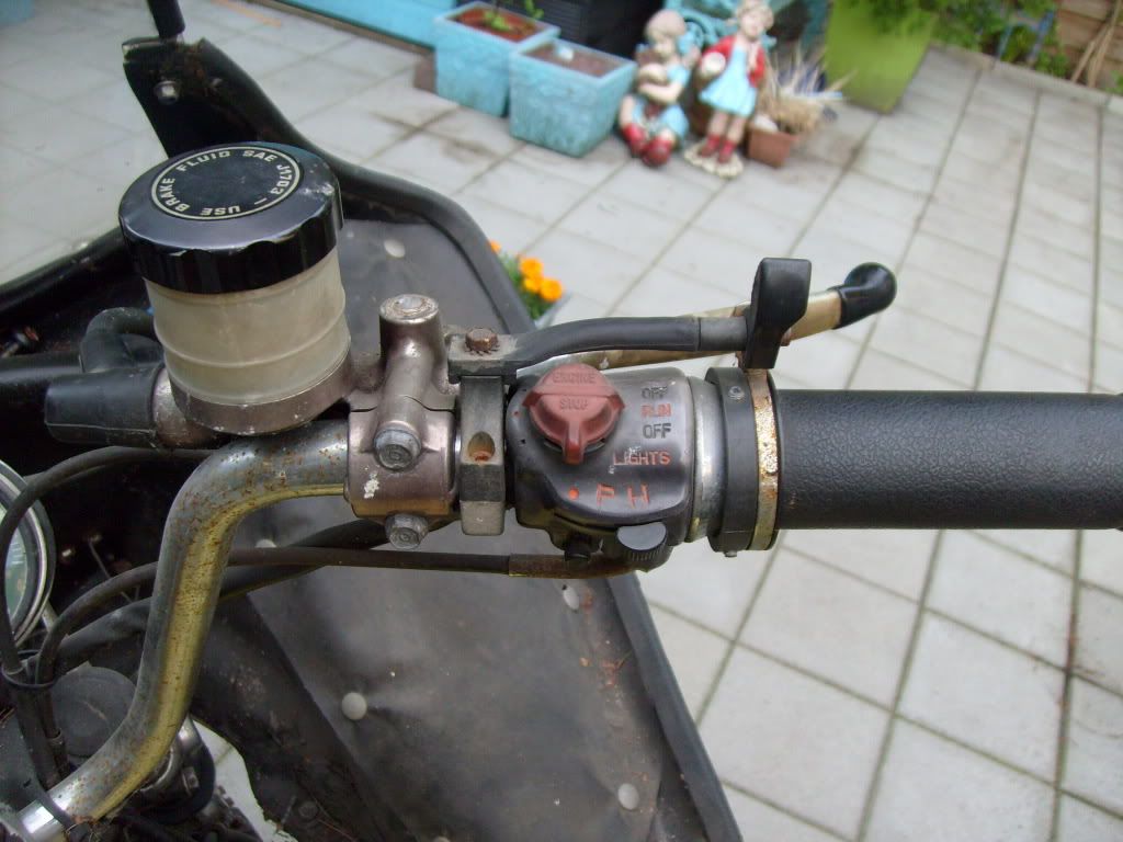

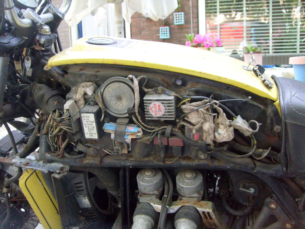

and i found some very strange electical parts in my fake tank something like a 2nd horn and a homemade switch I think, hope you guys know more of it and tell me.
Looks like the previous owner broke or cut one of the bolts of for the placement of the cilinderprotector..Could it be replaced from the inside?

this is the crazy switch by the way
