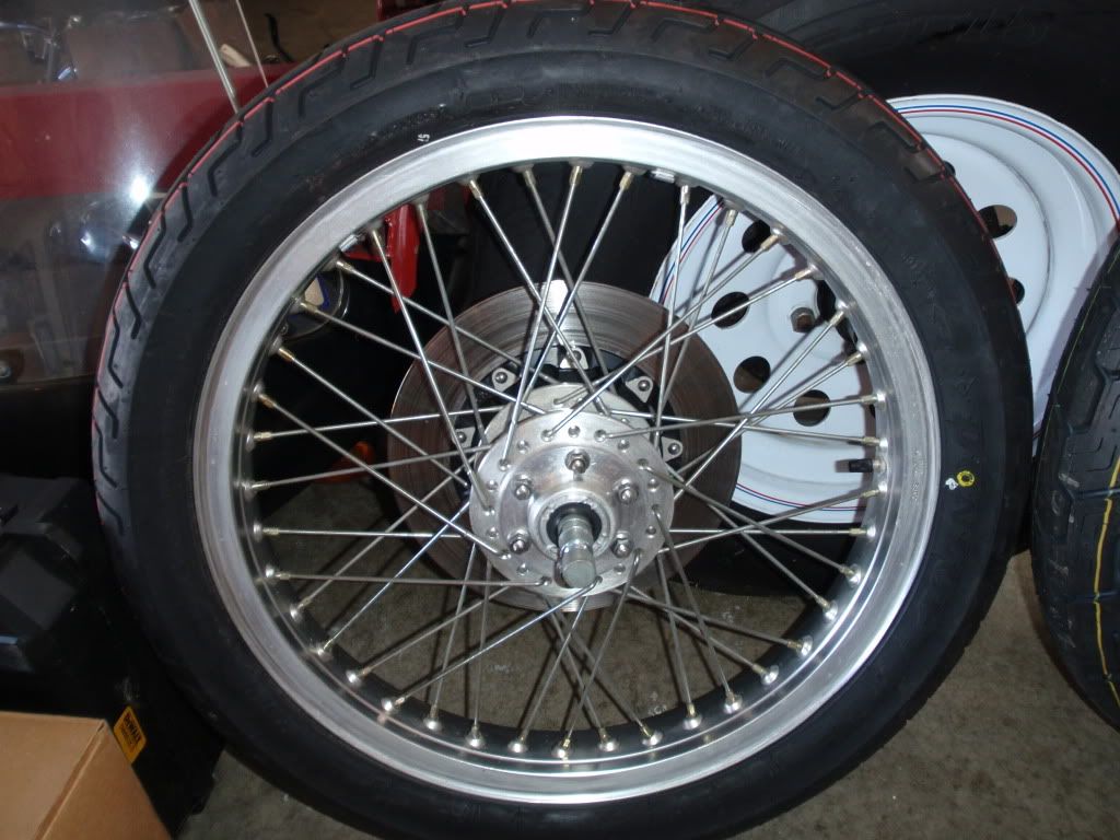

Greetings Polkadot77,
Your wire wheels look to be in rather good shape per the photo's. Are the spokes as clean as they look? Or will you or did you need to remove any rust from them?

Fred, I have not done anything to the wheels yet. They are in pretty good shape. There is some crude on the spokes but no rust. I think some fine steel wool and polish will do the trick. I see you are in Detroit. Maybe when the beast is complete we can get together for a ride. Ernie

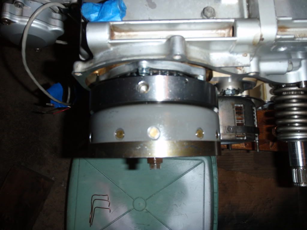

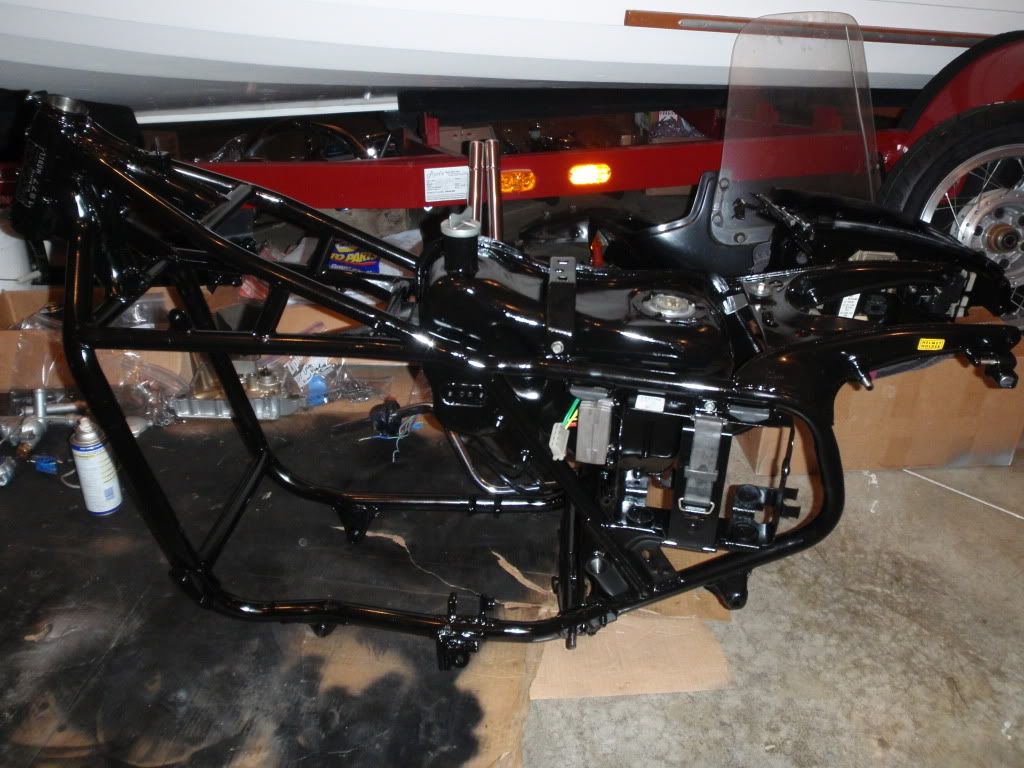

I worked on the bike most of the weekend. I have been cleaning polishing and painting mostly. Most of the bike parts are ready to be installed and are being stored strategicly under my boat. Image As you may remember I had a really rusty starter clutch and rotor. Got a replacement from psychocycle and installed it Saturday. I had trouble getting it in place on the spindal so I made three "starter clutch assembly tools". They can be seen in the attached photo. Do not be fooled. They may look like pieces of bent wire but much design engineering went into them. Image As you can see the clutch looks much better. I did manage to get the seals out of my front forks. I did not realize that there is a tool known as a seal puller. (this shows my level of mechanical knowledge) I am still fighting the water pump. It seems to be "welded" in the cover. I will keep soaking and tapping. (the force is getting greater) The bike frame has been completely painted. In fact, I began putting components back ON the bike. Image I also installed the new timing belts. Long story short, If the engine is at TDC and both pulleys say up and the arrows point to the marks on the cover (right and left), I am good to go? That seems what everything boiled down to! Image I also got my gas tank back and new tires. I got the Dunlop 404 tires. I think they look good and am told they perform pretty well. Image I'll keep plugging along and will keep you posted. I think I am beginning to see a light at the end of the tunnel! Ernie
