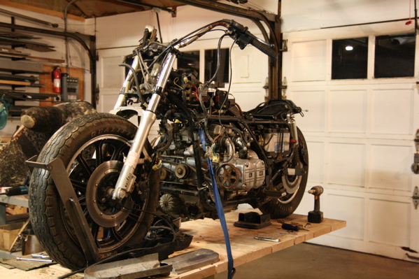

Hey the photo worked!
Can anyone tell my why my login won't work in the gallery section?
More pics:

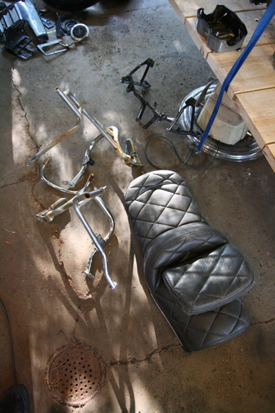

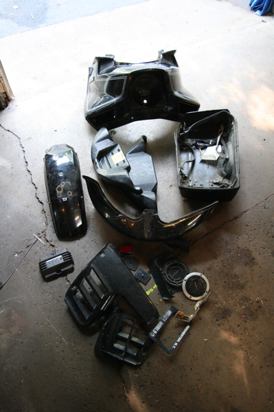

Thinking
Stuff I wont be needing!
(I'll trade you for parts I do need if you see something you like
(or you can just have it....)
Probably wont be needing these either.

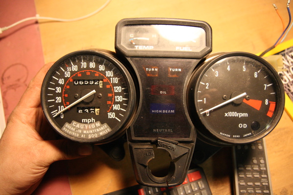

Pretty low miles, love the service sticker that was never removed, probably never had the service....
And already well on the way to looking how I want.
Thanks for all the help you guys have already been, been able to find tons of great info here.
Off to search for where to get the best service manual.

Thinking

I would like the case guards.
I prefer that style of wraparound to the ones that just cover the front at the timing belt covers.
Plus they clear all the vacuum connections for syncing.

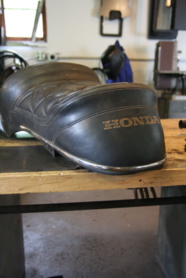

I'm interested in that seat.
What year is the bike?

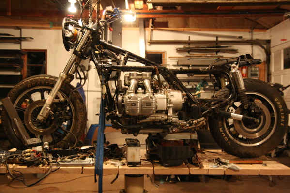

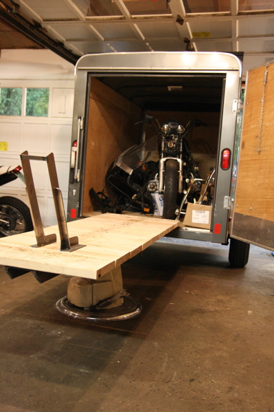

When you get a chance, maybe under a different thread,
how about some pictures of your work table there.
How is it balanced, is it a turntable arrangement, that kinda thing.

"Naked bike in a Kit"Roady wrote:You saved a lot of time in the strip down phase! 8)
When you get 10 post, send a PM to RAT and he'll set you up with an album. Then you'll be good to login.
Thanks for the album tip, I'll be at 10 in no time with all the questions I'm gona have.
And I'd ask what you wanted to trade for the seat, but that carb write up is plenty for me! Doubt I'll be using the seat and it seems in great shape, yours if you want it.
And yup. it's an 83.

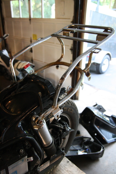

Pretty sure those are the bars for around the side bags? They have passenger pegs on them and seem to fit back there?78AZWing wrote:I would like the case guards.
Don't think it had any crash bars, the PO put those few miles on it and then dropped it on the left side and parked it in what looks like 1985.

I like the "600 mile oil change" sticker on the speedo, I'll bet it was never changed.
It is an old dentist chair base, barbers chairs are similar but not as heavy. They make great little work tables since they are crazy stable (ie, weigh a ton) and they go up and down on a big hydro cylinder.
I use this for much lighter bikes and the whole thing tips down to meet the ground like a ramp, roll a (lighter than a wing) bike up on it and the thing tips back down like a see-saw (there is a gas shock on the one side to make this a smooth motion) and the bike sits up there in the wheel chock. Having the work at sitting height (or standing height with the stand jacked up) is the only way to go. the table is pretty rough around the edges, but it sure beats working on the ground.
I'll get more pics when the current load is lightened a bit.

Now that is pretty cool. :anim-cheers1: :respekt2:
How do you plan to get 600 or so pounds of motorcycle back down to the ground without it running away from you? You loaded that bike from the back of your trailer, right?

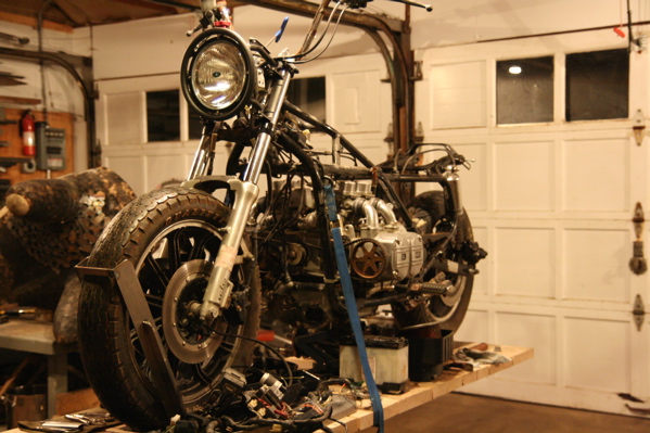

The huge headlight bucket looks kinda cool. Seems to help with the scale of the bike.
Thanks for the seat, I'll put it to good use. I cut my original down and it's just a little too small for my wide a!$ now.
I have an old rear MC from an '80 (I think) and will send it if you think you could use it. Needs rebuild but it might help you out.
- Posts: 154
- Joined: Sun Apr 12, 2009 9:11 am
- Location: Eugene OR, USA
Ah, photos fixed, that is much nicer.
The seat's actually pretty cool, would be neat to figure out how to use the back end, nice shape.
I was just thinking with the enduro light, but I actually really like it, the tube frame continues the top frame tubes very nicely.
My plan is to actually leave all the frame tubes exposed, I think I will skin the inside of that top part with panels, clean the tabs off the frame and leave it exposed.
I'm not kidding when I say it is starting to look how I want, I'm going REALLY naked.

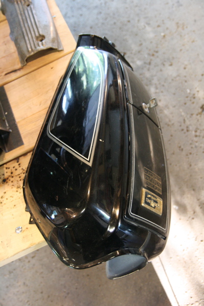

The tank was about as rusty as I have ever seen, no salvaging that without cutting it open, that is ok though, I will keep the tank location the same but find/make (or some combination) a moon style tank and mount it transversely under the seat, move the battery up above the transmission (not really move I guess, but replace with a cube gel style one) and run without the side covers.
