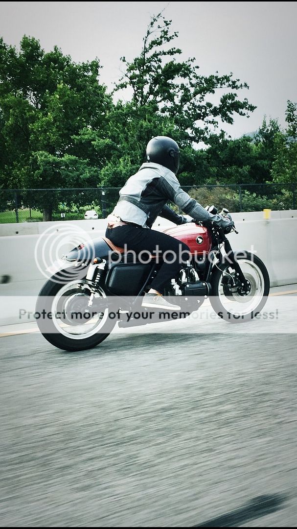

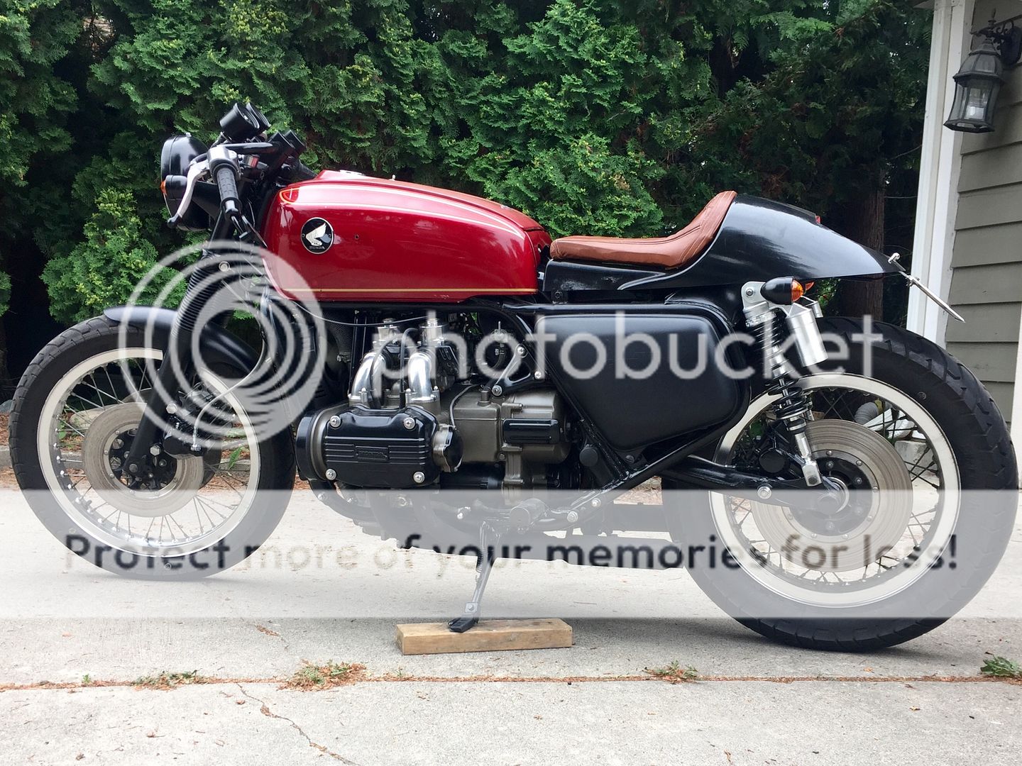

Painted the side covers satin black to match the front fender (just whoring out pics at this point

Re: My 75 Wing Cafe RestoMod
Nice riding boots, er, shoes.

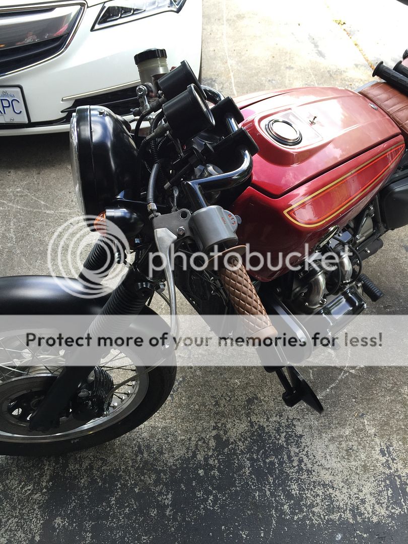

Not too much new in the last couple weeks. One of my closest friends and riding buddies got in a wreck last week. He was merging into the freeway and the car in front of him came to a sudden stop while he was shoulder checking. He almost avoided it but ended up clipping the rear quarter panel and went down. Shattered his left forearm and now has a titanium plate and 13 screws holding it together. We're already started repairing his ride though.

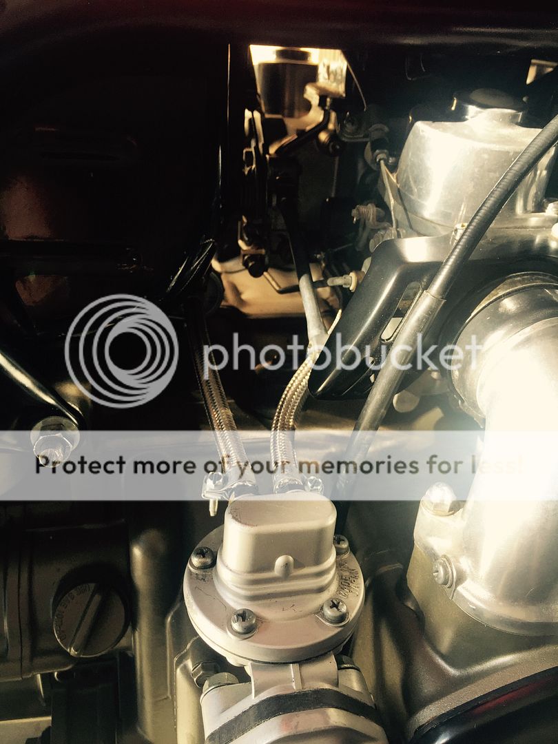

I put on some new Biltwell grips and changed my fuel filter and fuel lines. Went with braided Stainless automotive line which matches my braided stainless brake lines.
I ordered a new tach and speedo cable and I'm planning on figuring out some custom routing to eliminate the bend at the connection to the gauges and hopefully fix my issue with tach and speedo cables breaking (one speedo and two tach cables so far. Might go right through the headlight shell and use rubber grommets top and bottom to seal it all up. Still undecided.
AWESOME SETUP! wondering what that front fender you are running is from?
Thanks guys! The front fender is a fiberglass Ducati replica from Airtech.
http://www.dimecitycycles.com/airtech-d ... ender.html
I did a lot of trimming and shaping to get it how I liked but it was a good base to start and easy to work with.

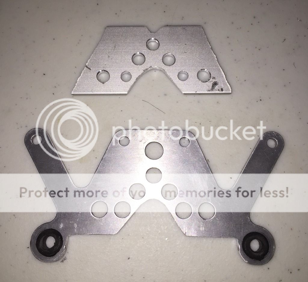

Regarding your cable issue - do you think you could bend the bracket down so that the two gauges are more horizontal, allowing the cables to exit in a more vertical downward path ? If that's at all possible it may do the trick.
Your pics are great
Your pics are great
- Hanslehoff
- Posts: 363
- Joined: Tue May 06, 2014 12:30 pm
- Location: Canada
I did have to bend the bracket to begin with but because of the type of LED's I used and the location of the ignition and triple clamps I can't flatten it out any more.Norbert R wrote:Nice work![]()
Your pics are great

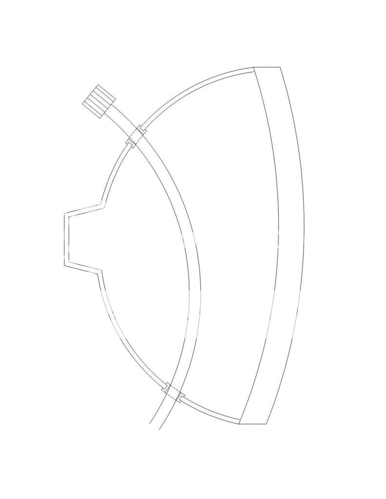

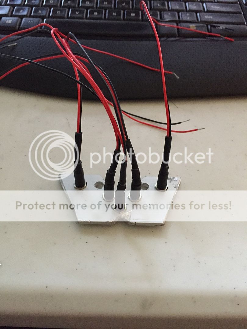

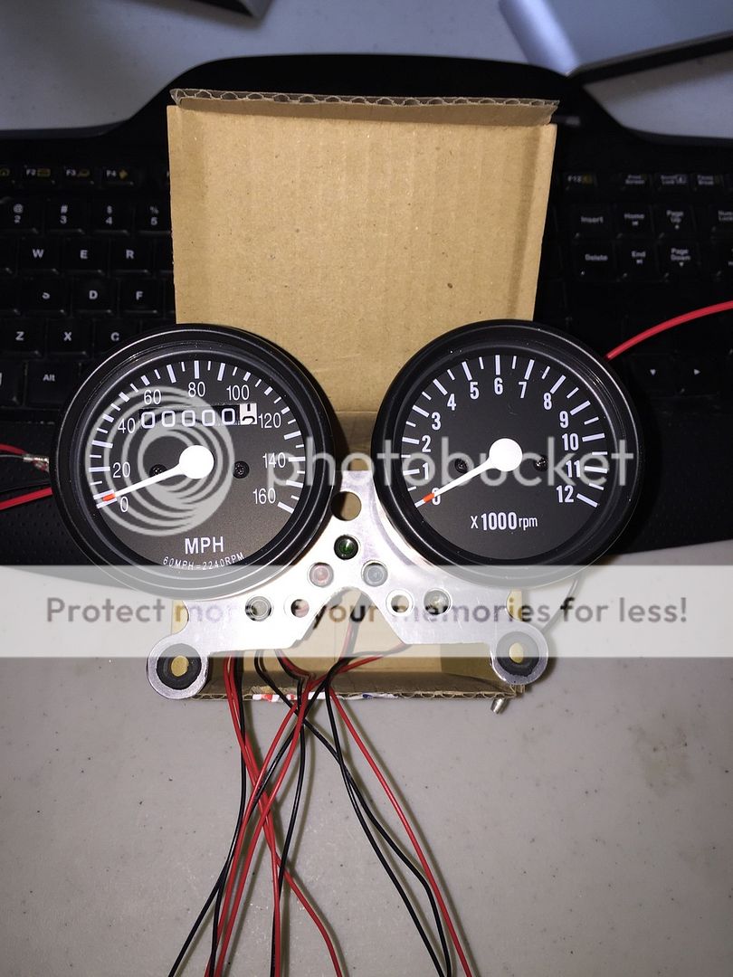

I just realized I never posted any pics of the gauge build. I started with a billet bracket for a CB750 which I thought would be a direct fit. It was not, and took a lot of cutting and bending. I bought 6mm LED warning lights because I wanted them flush mounted, which meant I needed to build another aluminum plate to hold the lights which got bolted to the bottom of the main bracket.
Once the LED's were mounted and sealed they stuck out the bottom of the bracket about an inch
When I went to fit it the back of the LED's interfered with the 'block' on the ignition switch. I dropped the ignition switch about an inch but then it hit the back of the head light shell and I had to do some modification there to get the light aimed correctly (everything effects everything!). Long story short by the time I got everything mounted and working that's when the issue with the cables breaking at the sharp bend cropped up.
So now my idea is something like this:
1975 Cafe Wing
