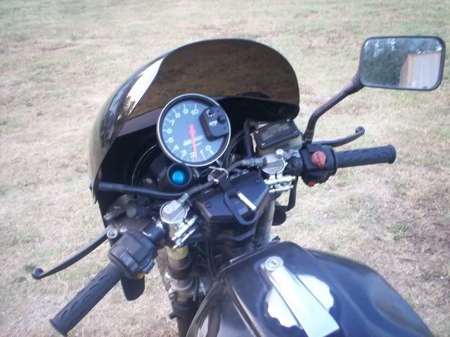

The clip ons look just like mine.safarjoe wrote:![]()
cafe racer bars

Hear's the setup I ran on my CB900F SS.

My wing has such a long throttle tube that I know I could cut about .5 inches off of it and it would be just about right. If you cut yours down and get shorter grips and move it outboard some, would that give you enough room?safarjoe wrote:how did you mount the master cylinder/lever, It's not really fitting right... I can't push it down far enough to make it comfortable - the tach gets in the way

Here is a thought.
two scenarios,.
1. Pull your forks up and fully attach the clip-ons above the top tree.
2. Lower the forks slightly in the triple tree and attach the clips under the top tree.
In either case, the clips will be almost the exact same distance from the ground give or take 3/4"
In case 1, by pulling the forks up, the front end is lowered and the trail shortened.
In case 2, the front end is heightened and the rake increased.
I believe the best solution is to not move the forks in either direction, and attach the clips to the forks under the tree. This gives you an aggressive riding stance, while leaving the bike with the rake and trail Honda engineered. I rode this way to Deadwood and back (3100 miles) last summer, and it was great. Granted, I had clubmans, but they sit right where clip-ons would. Once one gets used to the stance, it is like steering a tiger by its ears.
One more add. I use bar end mirrors on Vyper. They are okay, but you have to be on your game, as there are serious blind spots. Again, once you get used to them, you know how to play the game and where to look for danger.
A couple other thoughts. You could replace the stock shocks with longer ones that would allow the shocks to protrude above the triple tree and not effect the rake and trail. And you may want to consider longer clip ons to allow for easier mounting of your controls.

yea all that makes sense, I'm making a cafe seat so I want to see what my riding position is like before I put the clip ons under the triple trees... I'll figure something out, thanks for the input

Good Evening Folks;
Safari-Joe are you serious about those clip-ons? With only half the fork tube engagement surface? Standard engineering practice says that you need at least 2 tube diameter's engagement for full strength. I hate to think what would happen if one bar came off at speed. I built my own bars for my Wing-Lite using a standard set of Euro bars and welded 2" long extensions on each side to get everything to fit.

Now I see it:
I wouldn't want to do that either.

From Joe's first post in this thread:
-Deek
No worries. He's all over itsafarjoe wrote:Some pics of my progress... still have to lower the fork tubes to make more room to mount them properly, just wanted to get them on to see what it's like....
