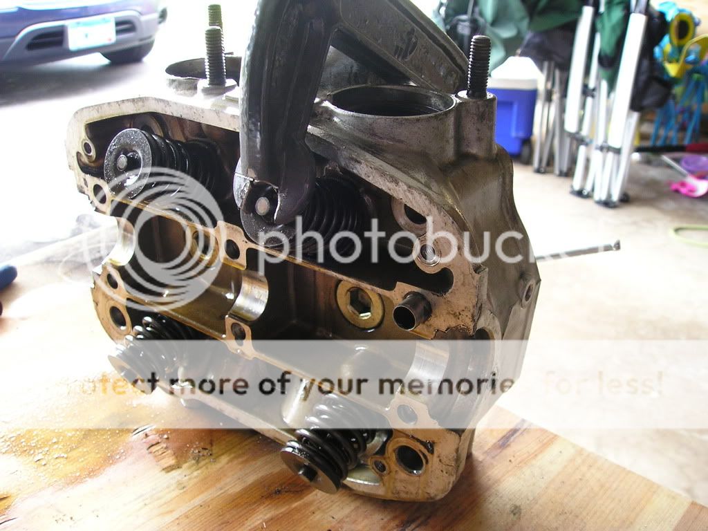

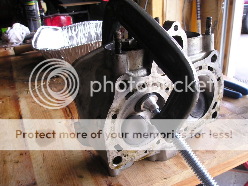

A large C-clamp with a hole ground in the end works like a charm:
