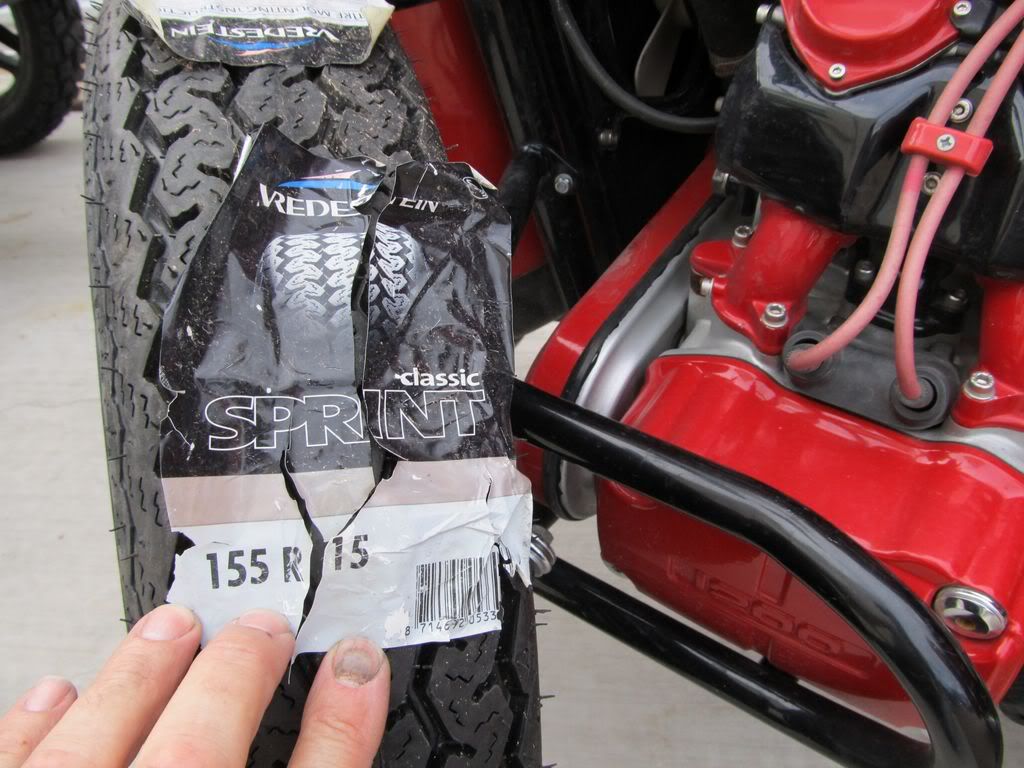

On my 1200 hack I wanted to fit a car tire. I get less than 5000 miles on a rear E3. I talked to (forget his name) the tech at Motorvation sidecars. He has fit a VW tire onto his 84 1200, no problem. I was there (his shop in Iowa) a couple weeks ago on a trip to Minny Soda and saw it myself.
About 6 months ago (after I first talked to him about this) I tried fitting one to my 1200 rear rim. Went with a Vredstein 155R15, an equal to the VW tire size.
NOTE: With a bit of searching, you will find many warnings about putting a car tire on a 1200. The bead area is slightly greater in diameter than a car wheel of equal size; I read somewhere that years ago (when GL1200s were actually in vogue...) that a machinist gentleman actually had a jig built to take several thousandths off the bead, while the wheel was ON the bike and using the engine as a motive source. He did this at Goldwing rallys; or so I read...
So I bought the tire, and took it to a local shop. I warned him that this may/should work, but we needed to be real careful, as some had to use extreme pressure in order to seat the bead. He said "no problem" and said he would be real careful. I was watching/helping him mount it, and he got interrupted several times. So when he went off talking on the phone I went next door to a machinist shop as I had business there. Shortly thereafter, we heard a POP/BLAM, and the building slightly shook. Then a whole bunch of cursing.
Went next door, and the tire guy was holding his very red/swollen hand up in agony, bouncing around and cursing up a storm. The tire looked like this:
We got him loaded up on advil to combat the swelling, and cleaned the cut. He was a big muscular guy, and was very very lucky. Nothing broken, but badly bruiosed and swollen.
So. Yes, it can and has been done; but I will never try it again on a 1200 stock rear rim.

Pago cruiser; Wow, that is a scary picture of a tire.
I am not a Vulcanic expert however, it appears as if the tire had been seating around for a while before selling and weakened over time. Whatever. :popcorn:
I really appreciate your taking time to post the story and showing the photos. action1

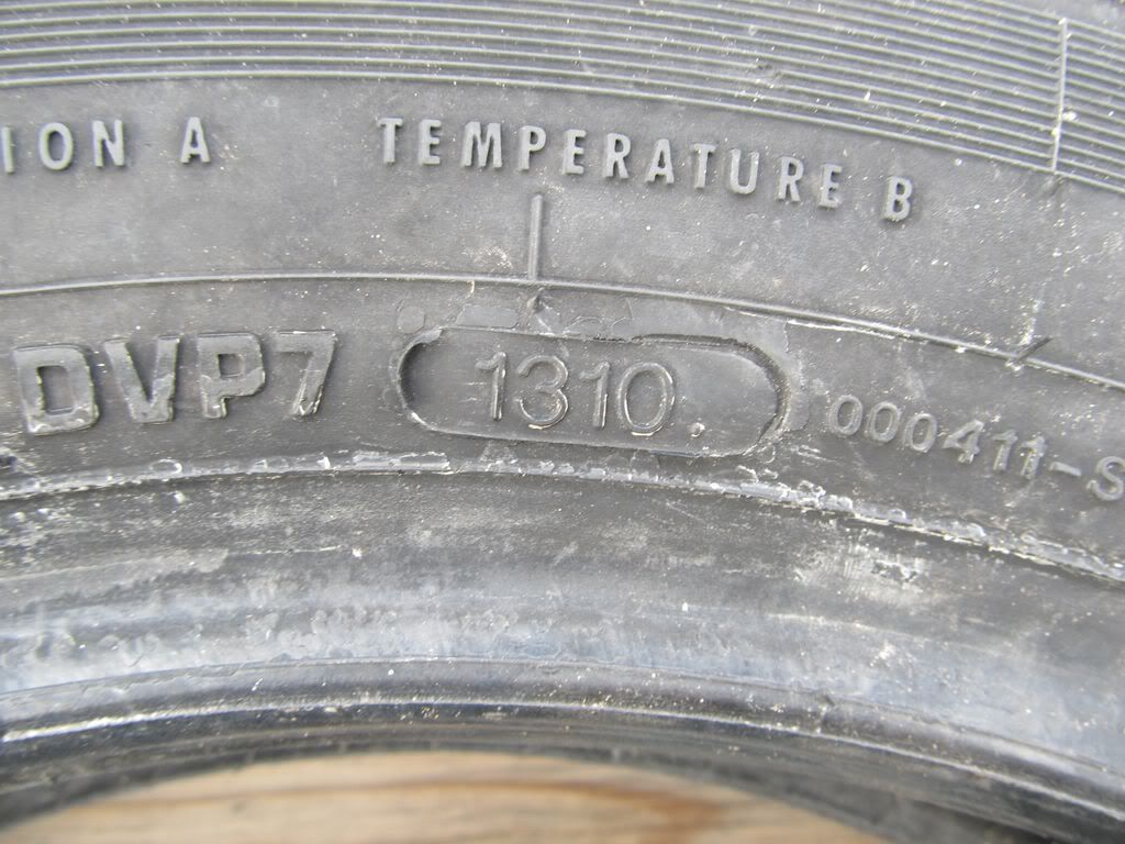

"I am not a Vulcanic expert however, it appears as if the tire had been seating around for a while before selling and weakened over time. Whatever."
Nope. The tire was purchased from a dealers current stock. I know I said 6 months ago, but as this is August already, it had to me more than 6 months. I know it was last year, so it was somewhere fall of 2010. The tire has been sitting out in the AZ sun since the incident. Here's a pic of the "born on date", the 13th week of 2010. The tire was flawless and supple when we attempted installation.
I spent quite a bit of time doing research and trying to get current info on car tires on GL1200. And learned first hand (well, it was someone elses hand...) that it is not as simple as it sounds on the 1200. But eventually I am going to do this on the 1200 hack. I'd be further along than I am, but my first welder butt-welded the tubes (1500 to 1200) without a reinforcing sleeve. Good welding, but a poorly engineered weld. So now I gotta do it again... At any rate, glad to share the info. anim-cheers1
